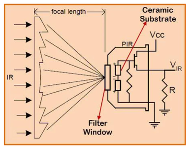

PIR sensor (Passive Infrared Motion Detector). As the name suggests it doesn't emit radiation like an active sensor but detects the change in infrared radiation of the source.
Working Principle:
  • It works on the principle that whenever it detects a change in infrared radiation, it generates a digital output signal as a response.

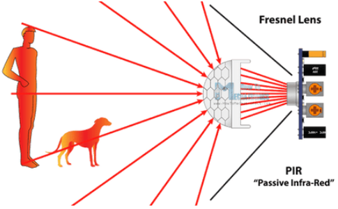

  • Fresnel lens and pyroelectric material make up this device. The incoming infrared radiations are focused by a Fresnel lens constructed of high-density polyethylene such that they fall off the pyroelectric substance. The sensor may be more resistant to noise, temperature, and humidity with the help of metal. Infrared radiation variations are detected by pyroelectric material, which then produces an output signal.

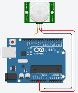

Step 2: Connections
1) Connect the GND of Arduino to GND Pin of PIR sensor.
2) Connect the 5V pin of Arduino to Vcc Pin of PIR sensor.
3) Connect the pin12 of Arduino to Signal Pin of PIR sensor.
According to the above diagram:
1) Red wire: power
2) Black wire: ground
3) Orange wire: signal
