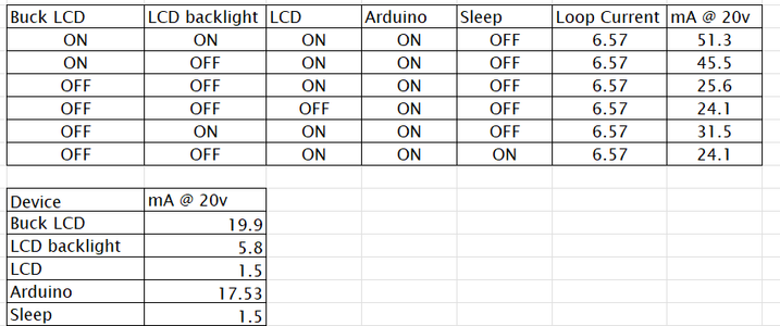

I have an external LCD screen showing current mA, reading in engineering units, and the datafile name. The datafile name display helps keep track of which datafile corresponds to which instrument read.

lcd.init(); // initialize the lcd. 1.5 mA penelty.
lcd.backlight(); // Turn on the LCD screen backlight. 5.8 mA penelty

Step 6: Power Consumption Optimization
Since this device is battery operated, I wanted to understand how much power was being drawn by each component to rationalize what feature were worth the power being used. Knowing that the device will last 29.7 hours in the "base" configuration, I also extrapolated the expected runtime for each arrangement. I sorted the options based on run time and highlighted the features turned off in each step.
mA was measured using a multimeter at the battery. The Siemens P320 pressure instrument was kept at a constant 6.57mA. mW was calculated using the full 20V battery voltage (21v in my case).
It's worth noting that the LowPower.h library with sleep, ADC off and BOD off only reduced consumption by 1.5mA. There are some hardware tricks that can be done to greatly decrease draw, but that's for another day.
Something I did not expect is the massive draw of the Buck Converter LCD, it was nearly 40% of the entire baseline!
Additionally, when spaning your measurement the device, it would be more energy efficient to span it such that is stays closer to 4mA. Not something I had considered before this exercise.
