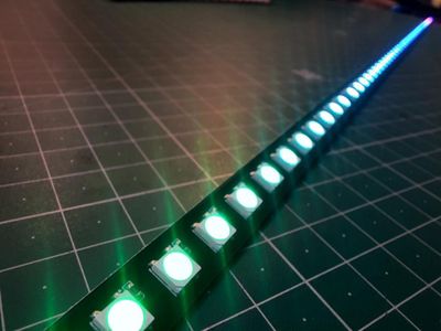

I made many projects regarding Audio amplifiers and preamplifiers but this tutorial is for the visual music experience. I am going to make a music reactive neopixel based LED strip. The LEDs will glow according to the change in beat and the color is changed automatically. This type of multi color RGB pattern gives a better look to home theater/ DJ system.
Neopixels are the addressable RGB LEDs and every single bit can be programmed separately with ON/OFF and a color from 0-255. These LED has 4 pins the data output of each led is connected to data input of next. Which make a serial data connection and a single digital pin is enough to provide control to whole stripe. These LEDs can work on a voltage of 3.3-5volt with a 20mA of current consumption.

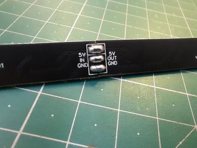

Step 3: PCB Layouts:
I made this WS2812 LED stripe using JLCPCB SMT assembly service and you can download all the required files directly from here. All the power connections are done in parallel and a small 100ohms resistor is placed as current limiter. All the data connection are done in series.
You can join multiple RGB stripes together to make a bigger one. There are 15 LEDs in one stripe, you have to modify the code line according to the number of neopixels used.

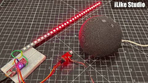

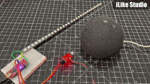

Step 6: Project Demonstration:
Project is working very fine, As I said earlier potentiometer should be tuned precisely with respect to the audio volume to get the full spectrum on the VU meter.
Increasing the volume will increase the brightness and glowing values. Similarly if the volume goes down the LED stops blinking and effect is vanished.
