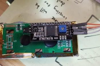

Step 1: Connect the LCD

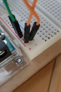

Take the LCD and 4 jumper wires. Connect one end of the jumper wire to the connection point of the LCD, repeat this process four times until all the connection points of the LCD have been connected to a jumper wire. Then use the SCL and SDA end of the jumper wires connected to the LCD (listed beside the connection point on the LCD) and connect it to the Arduino Leonardo board where it also states SDL and SDA (refer to the brown and green wires at the end of the Arduino board). The other two wires connected to the LCD connection points (orange and blue wires) should be connected to the top left of the breadboard (refer to the picture for detail). If a box is used for this project, place the LCD on top of the box for a better view.

Connect the three variable resistors preferable side by side by connecting the three connection points underneath each resistor to the breadboard. Make sure the resistors don't stay on the breadboard too long as it may damage the breadboard due to its larger connection ports. For each resistor, there are three connection points, so three jump wires are needed connection point. The connection point on the most left of the resistor connects to the positive electrode of the breadboard via jump wires(red plus), the connection point on the most right of the resistor connects to the negative electrode of the breadboard via jump wires (black negative). The middle connection point connected to the analog section of the Arduino Leonardo board for reading later in the code. Repeat all the connecting steps for all three resistors. Referring to the pictures above could help.

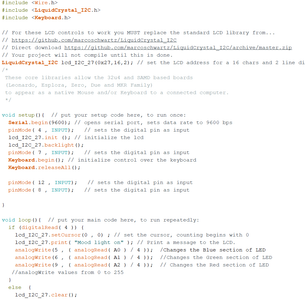

Step 5: Code
https://create.arduino.cc/editor/popul4r/e94fc2cc-...
You can access the code via the link above or download it in the file below
The code of this project consists of three main things:
1. The function of the four buttons
2. The function of the mood light
3. The function of the LCD
The coding of the four function buttons are simple; once the user presses on the button, the designated function will play out and the LCD will label the function, otherwise, if the button is not pressed, the LCD will not label and the function of the button will not play out.
The function of the mood light is activated once the "mood light" button is pressed and the LCD shows "Mood Light ON". After the activation, the variable resistors can be used to control the color of the mood light.
The function of the LCD labels the current action of the buttons pressed for more user awareness. For each button, a different message is labeled. When no button is pressed, the LCD clears itself.
Button and LCD commands can be changed for personal preference
