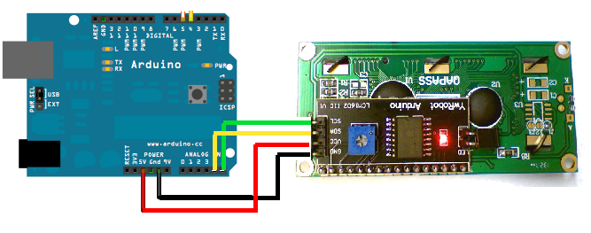

Step 3: Get Started With Project!!
For first you need to connect components to test board like shown on Fritzing picture!
You don't need servo motor or buzzer. in file Arduino_VRM.rar you will see VRM2 manual,
libraries needed for this program to run, that must be imported on computer and folder with Arduino code for this project.
Connect Arduino, install Arduino IDE, put components and burn the code/program on Arduino and you are good to go!
Connect LCD 16x2 with I2C module with SCL,SDA,Vcc and GND like on picture!
VERY IMPORTAT! First you must burn the code on to Arduino and then connect Voice Recogniton Module Tx and Rx pin to Arduino, becasue when uploading data to Arduino Tx and Rx pins are busy!!! If module is connected, code won't upload!
