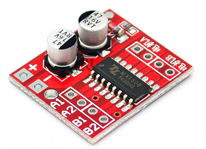

MX1508-2-channel DC motor drive module with forward/reverse PWM speed control

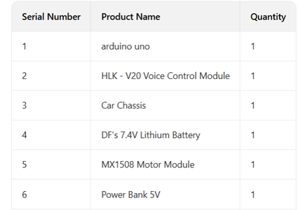

Required materials:

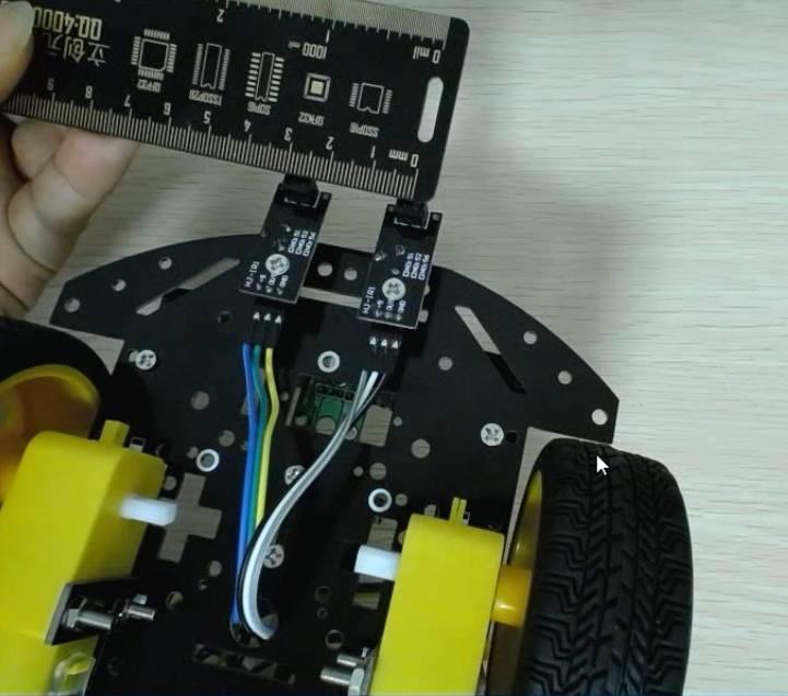

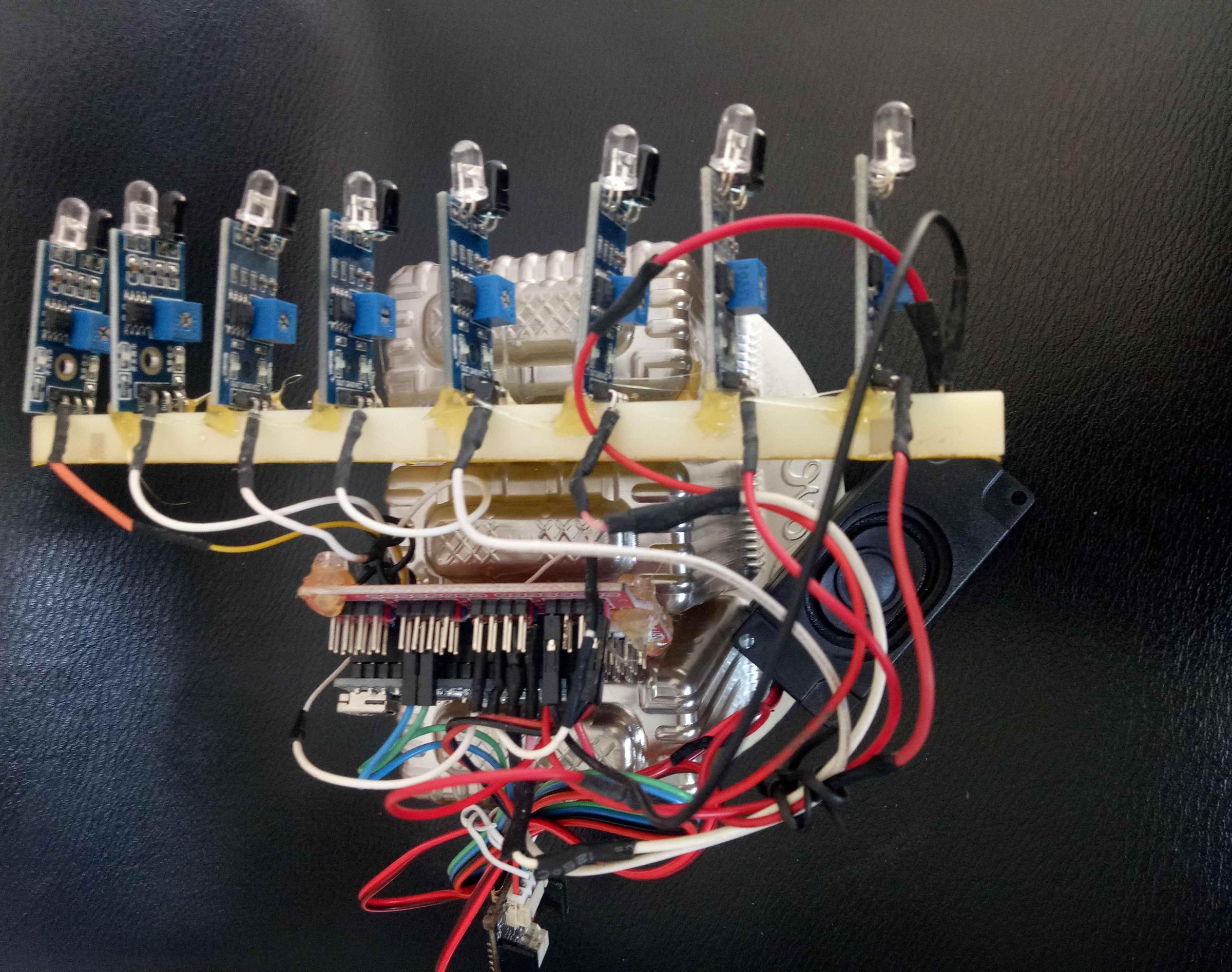

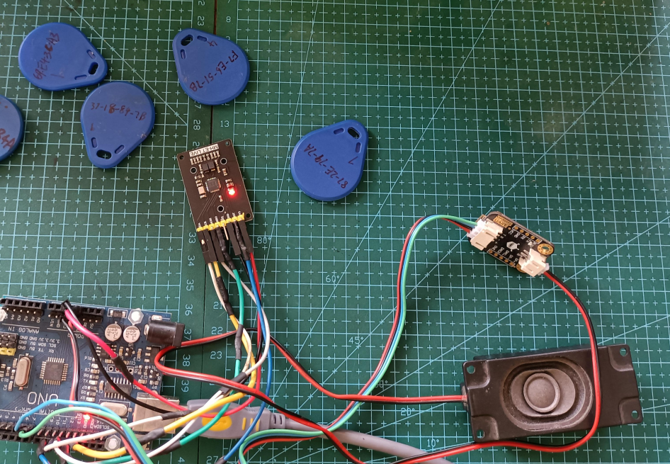

Step 4: Share Some Hardware Images to Provide a Visual Reference

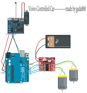

Step 6: Wiring Diagram
Limitations: The voice-controlled module may be affected by external noise. Using the voice-controlled module in combination with Bluetooth or other modules may yield better results.
