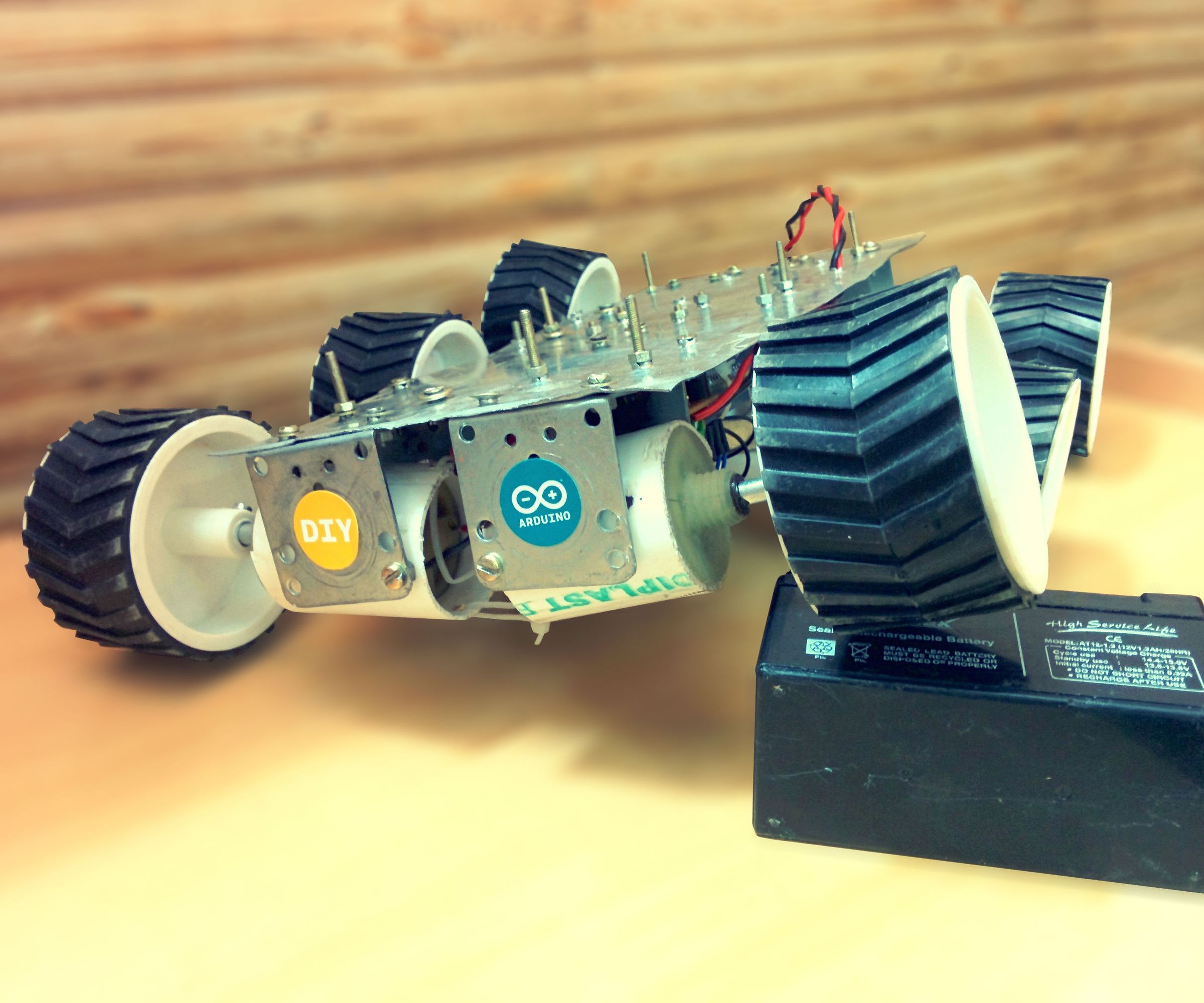

Introduction: Arduino Voice Recognition Via Bluetooth HC-05
It's really easy and quick to add voice control to your arduino project. Whether it is home automation or door lock, or robots, voice control could be one eye catching feature in an arduino project. In this tutorial I"ll show you how to voice control arduino projects without voice recognition shield. We"ll be using a HC-05 Bluetooth module. We"ll connect a Android device with HC-05 Bluetooth. Android Phone will convert voice into string of data using Google voice recognition software. This string of data will be sent to HC-05 Bluetooth module and then to arduino uno. After that, Arduino decodes and process it.
