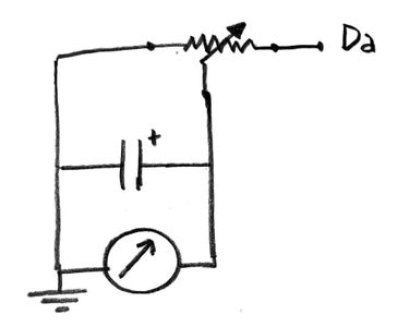

In the upper drawing, it is shown how to connect a general voltmeter display to its Arduino output Da = 9, 10 or 11 for hours, minutes or seconds respectively.
The 5 or 10 kOhm potentiometer shown in the schematic, acts as a Voltage divider and may be needed for displays that need a very small input voltage.
Consider the following example for the seconds (Da = pin 11):
1) To calibrate the end position of the seconds hand just replace the seconds analogWrite with:
analogWrite(11, int(x*256));
and try different values of x or regulate the potentiometer.
2) To calibrate the start position of the seconds hand just replace the seconds analogWrite with:
analogWrite(11, y));
and try different integer values of y, do not change the potentiometer. This calibration may be needed since the Arduino output needs a small offset to begin to generate a voltage.
3) Finally, once yo get x and y, the correct formula will be:
analogWrite(11, y + int(x*seconds/60.*256));
