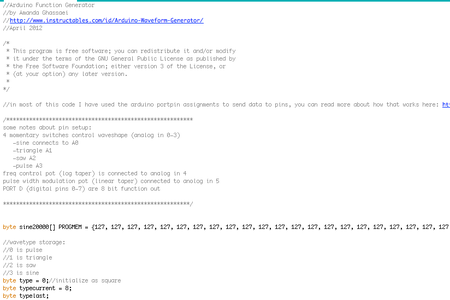

Step 13: Firmware
For triangle and saw I created the variables sawByte, triByte, sawInc, and triInc. Every time the frequency changed I calculated the amount that the triangle and saw function would have to increment at a sampling rate of 100kHz:
triInc = 511/period;
if (triInc==0){
triInc = 1;
sawInc = 255/period;
if (sawInc==0){
sawInc = 1;
then all the needed to be done in the interrupt routine was some simple math:
case 1://triangle
if((period-t) > t);
if (t == 0){
triByte = 0;
else{
triByte += triInc;
else{
triByte -= triInc;
if (triByte>255){
triByte = 255;
else if (triByte<0){
triByte = 0;
wave = triByte;
break;
case 2://saw
if (t=0){
sawByte=0;
else{
sawByte+=sawInc;
wave = sawByte;
break;
For the sine function, I wrote a simple python script which outputs 20000 values of 127+127sin(x) for one complete cycle:
import math
for x in range(0, 20000):
print str(int(127+127*math.sin(2*math.pi*x*0.00005)),)+str(","),
I stored this array in the Arduino's memory called sine20000[] and recalled the values I needed to send to the DAC. This is much faster than calculating the values individually.
