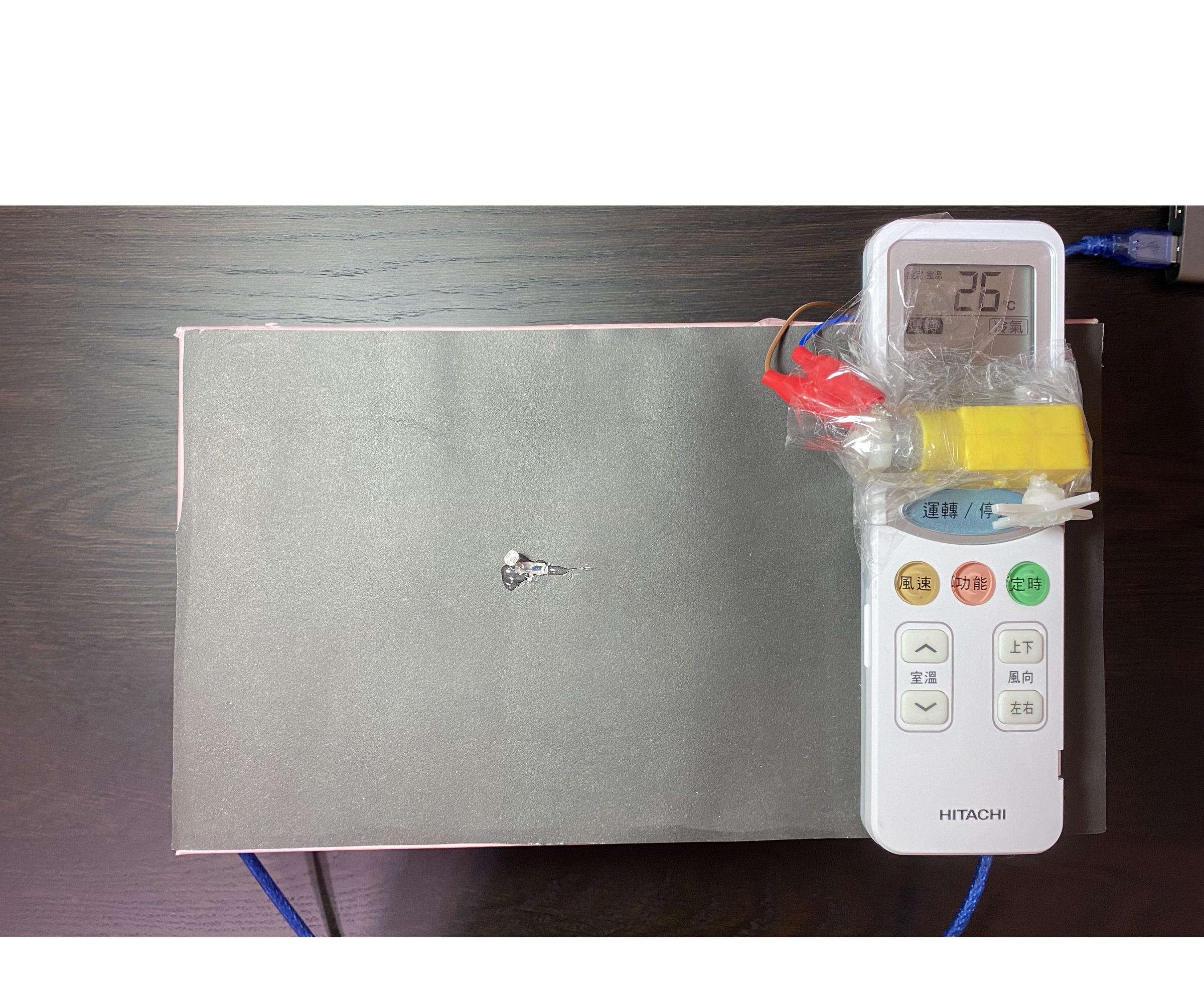

Step 5: Connecting the Circuit to the Product
First, connect one of the buzzer's alligator clips(see image 3) to the hanging wire of main wire and the other to the wire of the handle(see image 1). Next connect one of the LED lightbulb's alligator clips to the hanging wire of main wire and the other to the wire wire of the handle(See image 2).
Step 6: Finishing the Product
Now you can either choose to cover and decorate your product or just leave it there, in this case I used a shoebox to decorate my Arduino (See image 1).
