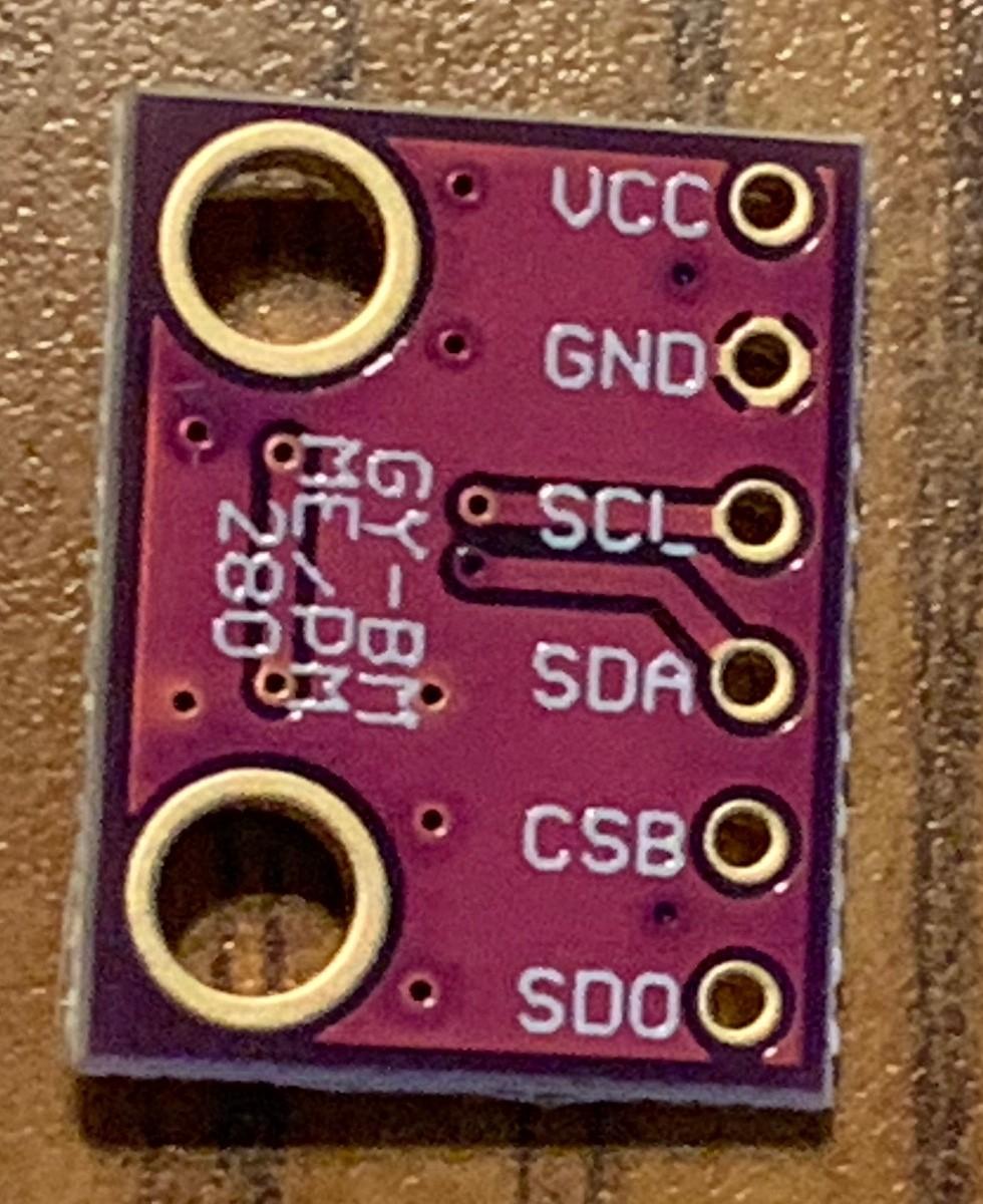

Step 4: Running Wires to BME280 Sensor
The BME280 sensor has 6 connections. Only four are needed for this project. I used solid copper wire to run between my weather station and the sensor and used 2 RCA connectors to connect the four wires so I could disconnect the sensor if needed. The red and white connectors are for the BME280 sensor. The yellow connector is for the anemometer.
Step 5: Container for BME280 Sensor
I soldered the wires to the BME280 sensor and put the sensor under the eave of my home in a small plastic container to protect it from rain and drilled holes in it to allow air flow to it. Not pretty, but functional!
