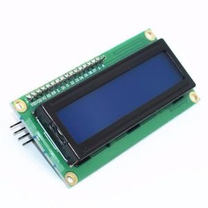

  • LCD I2C Display 20X4

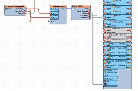

Step 4: For Sender Arduino - in Visuino Add, Set & Connect Components

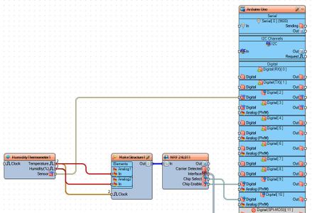

  • Add "Make Structure" component
  • Add "NRF24L01" component
  • Add "DHT" component

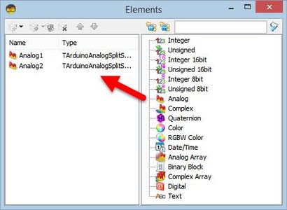

  • Double click on the "MakeStructure1" and in the "Elements" window drag 2X "Analog" to the left side and close the "Elements" window
  • Close the "Elements" window
  • Select "HumidityThermometer1" and in the properties set "Type" to the sensor that you use, either DHT11,DHT22,etc
  • Connect "HumidityThermometer1" pin [Temperature] to "MakeStructure1" > "Analog1" pin [In]
  • Connect "HumidityThermometer1" pin [Humidity] to "MakeStructure1" > "Analog2" pin [In]
  • Connect "HumidityThermometer1" pin [Sensor] to Arduino Digital pin [2]
  • Connect "NRF24L011" pin Interface [SPI] To Arduino board pin [SPI]
  • Connect "NRF24L011" pin [Chip Select] To Arduino board digital pin [10]
  • Connect "NRF24L011" pin [Chip Enable] To Arduino board digital pin [9]
  • Connect "MakeStructure1" pin [Out] to "NRF24L011" pin [In]
Upload the Project to the Arduino Board (see the Generate, Compile, and Upload the Arduino Code step)

  • Double click on the "SplitStructure1" and in the "Elements" window drag 2X "Analog" to the left side

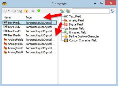

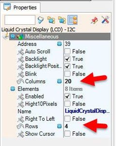

  • Select "LiquidCrystalDisplay1" and in the properties window set "Columns" to 20 and "Rows" to 4
  • Double click on the "LiquidCrystalDisplay1" and in the Elements window drag 4X "Text Field" and 4X "Analog Field" to the left side

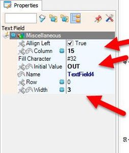

  • Select "TextField1" and in the properties window set "Initial Value" to "TEMP:" and "Row" to 1 and "Width" to 5
  • Select "TextField2" and in the properties window set "Initial Value" to "HUM::" and "Row" to 3 and "Width" to 5
  • Select "TextField3" and in the properties window set "Initial Value" to "IN:" and "Column" to 8 and "Width" to 2
  • Select "TextField4" and in the properties window set "Initial Value" to "OUT::" and "Column" to 15 and "Width" to 3
  • Select "AnalogField1" and in the properties window set "Column" to 7, "Row" to 1 and "Width" to 4
  • Select "AnalogField2" and in the properties window set "Column" to 7, "Row" to 3 and "Width" to 4
  • Select "AnalogField3" and in the properties window set "Column" to 14, "Row" to 1 and "Width" to 4
  • Select "AnalogField4" and in the properties window set "Column" to 14, "Row" to 3 and "Width" to 4

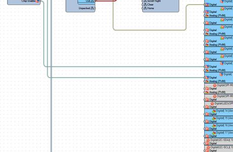

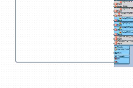

  • Connect "NRF24L011" pin [Out] to "SplitStructure1" pin [In]
  • Connect "HumidityThermometer1" pin [Temperature] to "LiquidCrystalDisplay1" > "AnalogField1" pin [In]
  • Connect "HumidityThermometer1" pin [Humidity] to "LiquidCrystalDisplay1" > "AnalogField2" pin [In]
  • Connect "SplitStructure1" > "Analog1" pin [Out] to "LiquidCrystalDisplay1" > "AnalogField3" pin [In] and pin [Clock]
  • Connect "SplitStructure1" > "Analog2" pin [Out] to "LiquidCrystalDisplay1" > "AnalogField4" pin [In] and pin [Clock]
  • Connect "LiquidCrystalDisplay1" pin I2C [Out] to Arduino pin I2C [In]
