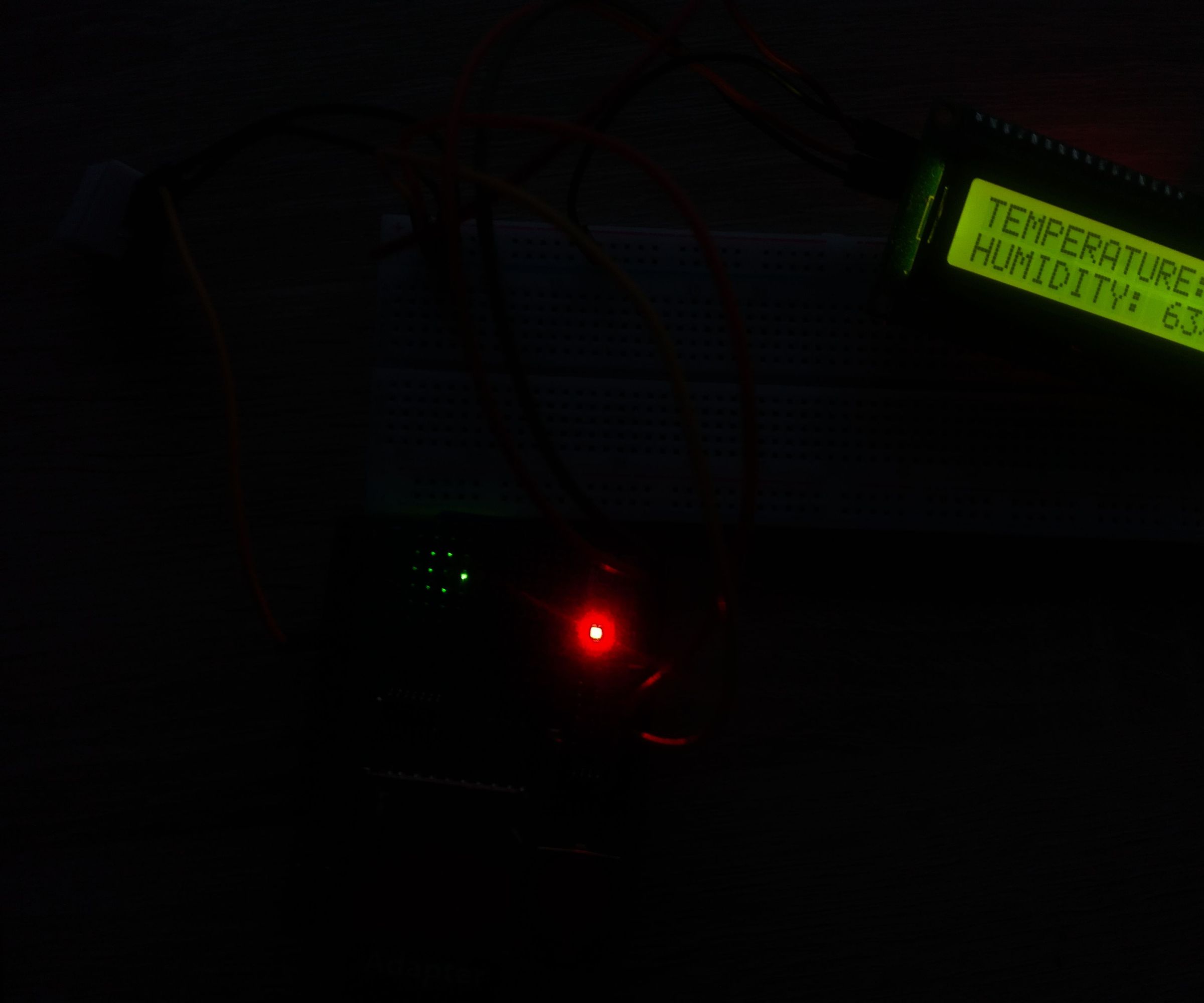

Step 7: Project 2
This is a little bit more complex project then the previous one, but it is also easy to make and I think that this one is better for understanding interrupts.
So in this code basically there are two FOR loops. One uses int i, and the other one uses int j. Int i loop is written on the top side of LCD, and j is written on the bottom side of the LCD. Main program just shows the changing number of i and j on the LCD until ISR is called. Blue led is working while main program is on, and if ISR routine is called blue diode goes off, and red diode starts blinking for few time. When ISR is called you can see on LCD that numbers that presents values of i and j are staying frozen until ISR is finnished.
You can even add buzzer to pin 10 to work like a door bell. The code for working with buzzer is in attachment.
