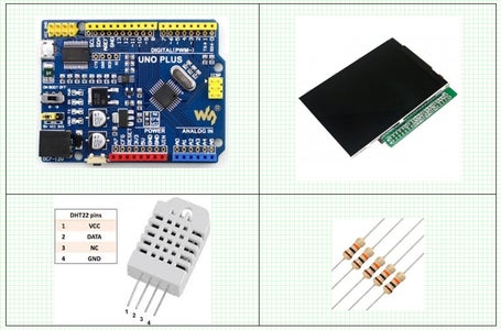

Parts and components
Arduino Uno board = 1 No
DHT22 (AM2302) = 1 No
320x480 TFT LCD (SPI interface, ILI9488 LCD controller) = 1 No
10K Resistor = 1No

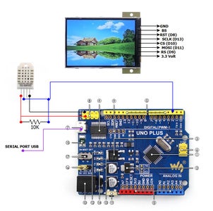

Step 1: SChematic
The TFT LCD (3.5 inch, 320x480 pixel, ILI9488 LCD controller), is used for this instructable.
The LCD is easily interfaced with Arduino SPI bus, and it needs minimum of four Digital IO lines.
The ILI9488 LCD Controller is a 16.7M single-chip SoC driver for a-Si TFT liquid crystal display panels with a resolution of 320(RGB) x 480 dots.
The ILI9488 is comprised of a 960-channel source driver, a 480-channel gate driver, 345,600 bytes GRAM for graphic data of 320 (RGB) x 480 dots, and power supply circuit.
The LCD operates at 3.3 Volt Logic.
Arduino SPI port is connected to the LCD ( D13- SCLK, and D11 – MOSI).
Arduino Digital IO pin D9 and D10 is connected to RS and CS pin of LCD.
DHT22 digital temperature / humidity sensor delivers temperatures between -40°C and +80°C and humidity between 0% to 100%. The temperature accuracy is ±0.1°C (maximum).
The DHT22 data pin is connected with Arduino digital IO pin, and pulled up to Vcc, via 10K ohm resistor.
DHT22 (AM2302) outputs calibrated digital data signal. Every DHT22 sensor of this model is temperature compensated and calibrated in accurate calibration chamber and the calibration-coefficient is saved in internal OTP memory.
The sensor supports long transmission distance.
Arduino reads the temperature and humidity at 2 second interval and sends to the serial port as well as displays on LCD screen.
