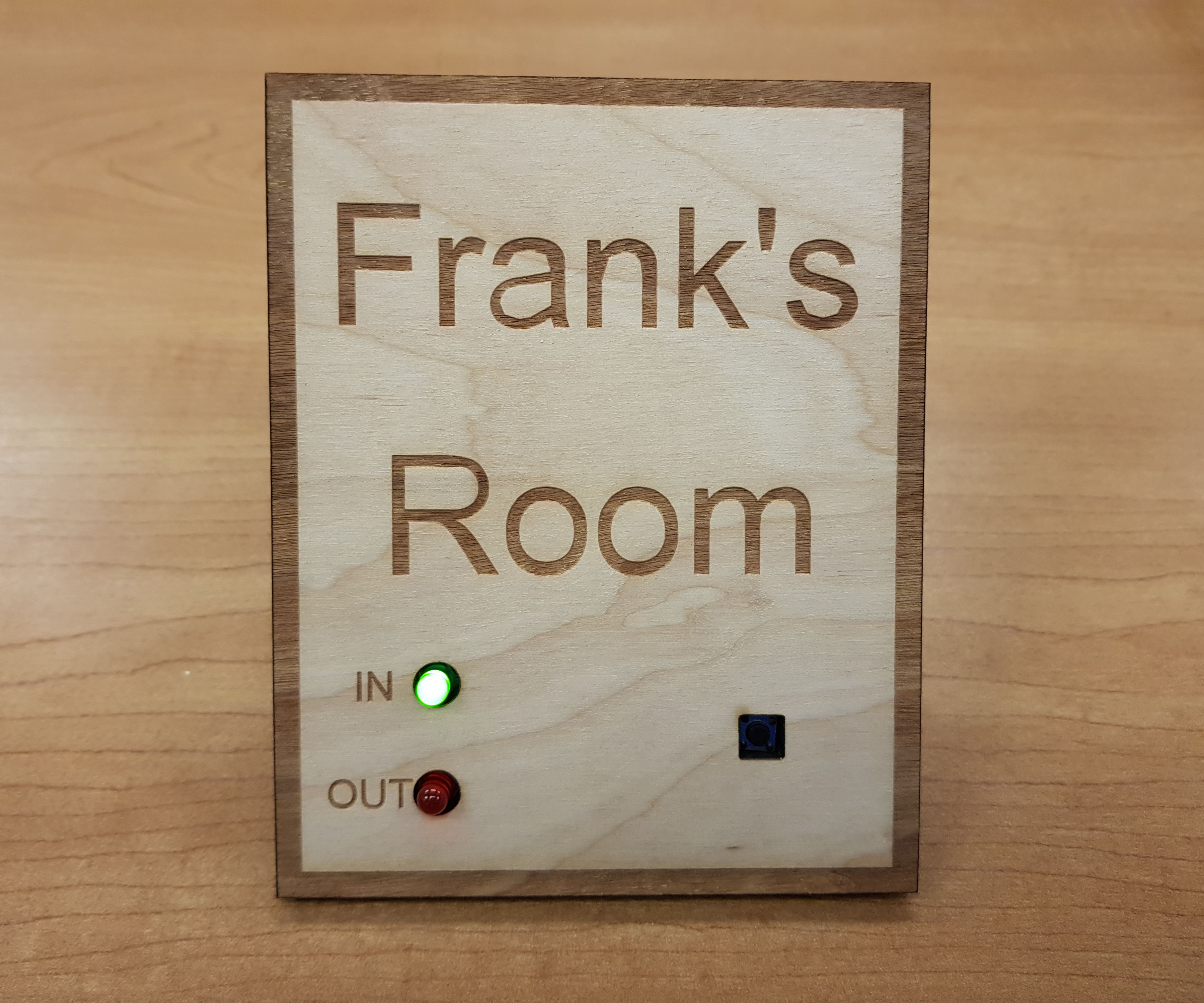

Step 9: Modifying the Circuit to Add a Push Button
In this step, we will be adding a push button to the circuit so that the LED turns on when the button is pressed. We will need to modify how the code and circuit works in order for this behavior to be achieved.
A push button is a simple mechanical switch used in circuitry, often with a round button that can be pressed. These buttons often come with 4 little metal legs that curl and point inwards to the body of the button. Legs that are directly across from each other and point towards each other are a leg pair. The legs in a leg pair are always connected to each other in a button, and the 2 leg pairs on a button can be connected together based on if the button is press of not. When the button is not pressed, the switch is normally opened, so path between the leg pairs is broken, and no current can flow between them. When the button is pressed, the switch is closed, so the path between the leg pairs is connected, and current can flow between the two leg pairs.
To add a button to the Blinking LED schematic, we will connect the button to the Arduino in a specific manner for the circuit to work in the end. Follow along with the circuit schematic for a visual. First, we need to connect the Arduino's digital pin 2 (note that all digital pins except pin 0 or 1 can be used instead of digital pin 2) and a 10kOhm pullup resistor across a button's leg pair. This means that we need to connect pin 2 to one of the legs of the button, and the pullup resistor to the corresponding leg in the leg pair. The pullup resistor should then be connected to the GND pin of the Arduino. On the schematic, you can see this in how the pin 2 and the GND pin are connected on one end of the button. Next, we will connect the 5V pin from the Arduino to the other leg pair of the button. Note how the 5V pin is not connected to the digital pin and GND pin because the gate in the button is not closed (this occurs when the button is not pressed). When the gate closes, then the 5V is connected to the two other pins (this occurs when the button is pressed).
With the conceptual design done in the schematic, we should now design the circuit in TinkerCAD. We can do this by adding a button to the breadboard (buttons are usually placed across the bridge of the breadboard), and then connecting digital pin 2 to one of the button's leg pair. We will then connect a 10kOhm pullup resistor to the other side of the leg pair and then connect that resistor to the GND pin on the Arduino. Then, we are going to connect the 5V pin to the other leg pair, and our TinkerCAD model is complete. A picture of a correctly designed circuit in Fritzing and schematic are provided for you for reference; make sure you understand why their circuits look like that so that you can make your circuits with buttons and LEDs work.
Next, follow the TinkerCAD model with building the physical circuit on a breadboard. If you want to make sure you know which sides of the button are connected together, you can test continuity with a multimeter.
With the button added to the circuit, we can add the button into the Arduino code. In the code, we will set digital pin 2 an INPUT pin using pinMode(). This means that the Arduino will monitor digital pin two for any voltage coming into the Arduino. Conceptually, when the button is not pressed, the Arduino will read LOW voltage from digital pin 2 because digital pin 2 is connected to the GND pin (0V) of the Arduino via one of the button's leg pair. However, when the button is pressed, the button's two leg pairs become connected, connecting the 5V pin to digital pin 2 and the GND pin from the other leg pair. Because the 5V pin becomes connected to the digital pin 2, the Arduino will read a HIGH voltage at digital pin 2 because it is being input a 5V signal from the 5V pin. We will thus use this ability to detect whether or not the button is pressed and then change the state of the LED based on that.
Continuing on in the code, this code is going to differ from the previous code in that we are depending on an input from the button in order to turn on the light. The basic premise is a logic statement that checks if the button is pressed, then turns on the LED if it is. So, the code will incorporate an "if-else" statement that will turn on the LED when the Arduino senses a button press, and turns off the LED when the button is not pressed. The Arduino senses this by using the digitalRead() function to see if there is a HIGH or LOW voltage on digital pin 2, our input pin. Refer to the https://www.arduino.cc/reference/en/ website for more information on if-else statements or the digitalRead() function if necessary. While the code for this example is given to you in the images above, make sure that you understand how and why the code works.
Lastly, test and troubleshoot your circuit. If you wired your circuit correctly and used the code above, then your circuit should behave like the circuit in the video above. If your circuit behaves like it should, congratulations! You have completed a very useful Arduino circuit and you can move on to making your own circuit in the Electronics Tools Mastery Project. If not, double-check to see if your schematic is correct, then your TinkerCAD model, then your physical breadboard circuit, and finally your code.
