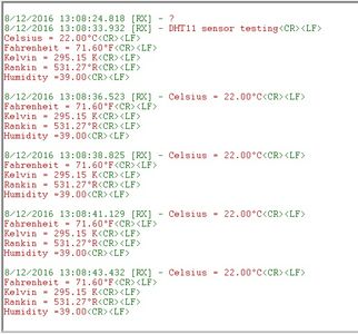

Step 3: Conclusion
The project is successfully completed with Arduino UNO and DHT11 module.
The converted temperature, and its serial port screen is given below.
