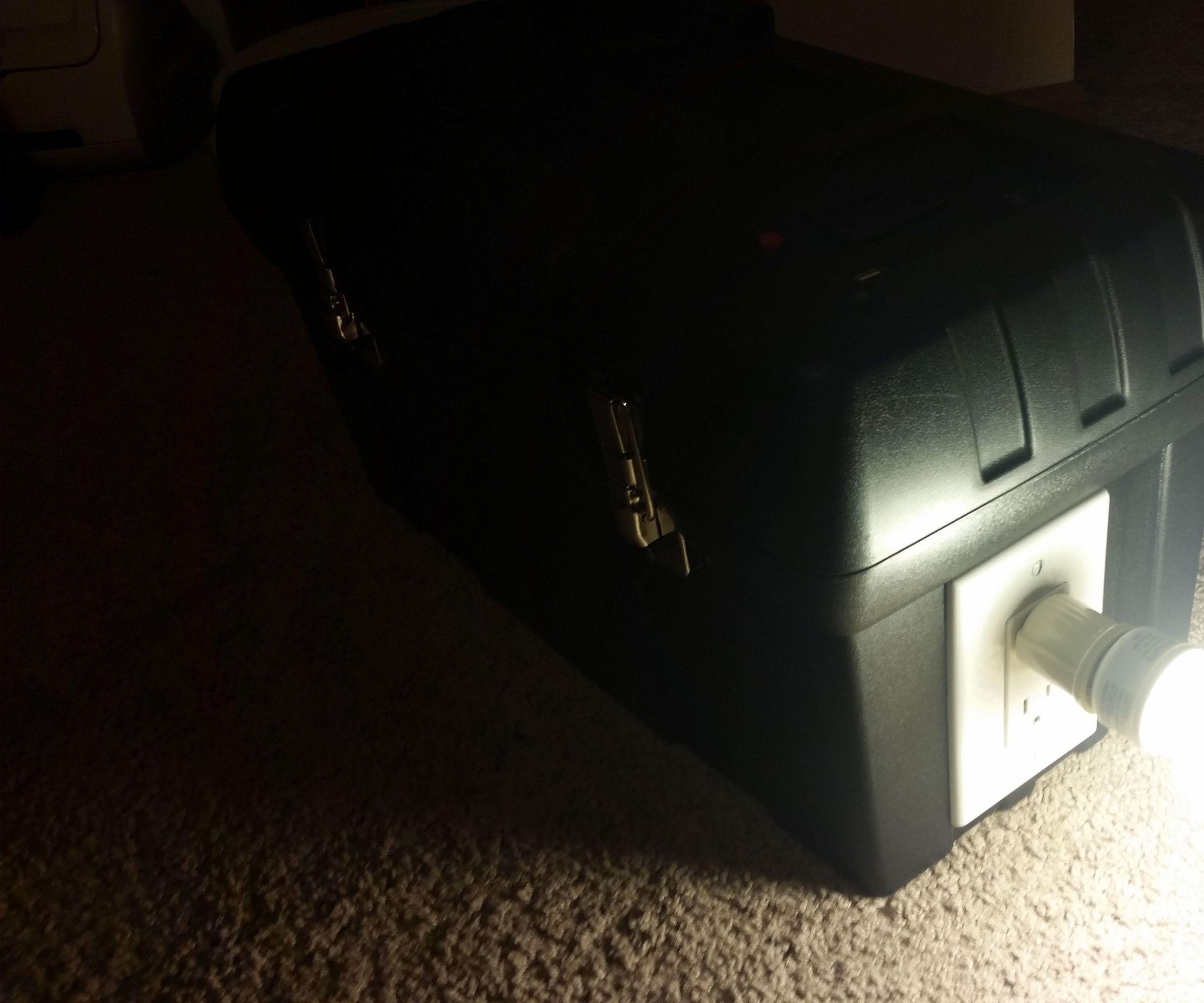

I decided to use a briefcase for the housing for all of the components, mainly because it can just be thrown in to the back of a car or trunk and taken wherever without the risk of damaging any parts. The link to the specific briefcase can be found below:
http://www.amazon.com/gp/product/B00I0HREBI/ref=oh...
The piece of acrylic in the middle was laser cut using an Epilog 40 Watt laser and I can provide the file for that if needed.
The red plastic standoffs screwed into the acrylic were 3D printed and I can also provide the stl if need be.
Using the original parts from the Dremel and not tearing apart the battery enabled me to remove the battery and recharge it on any compatible Dremel battery charger.
