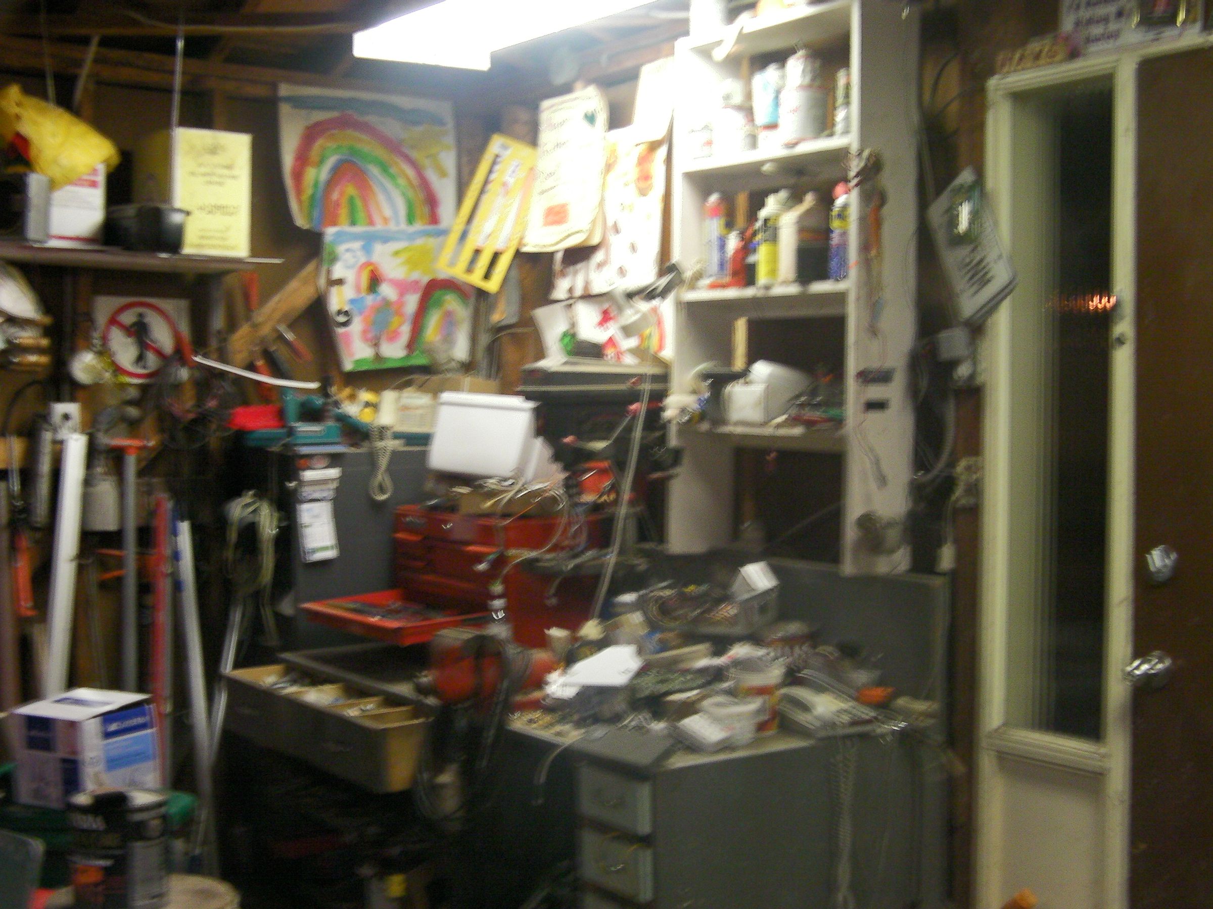

Step 9: Access the Interface From Anywhere
To Access the Rover From anywhere that has a internet connection I used a free Software called Log Me In .
It is a great software that allowes for you to log onto the slave laptop and control the mouse and keyboard allowing for you to drive the Rover.
Simply install the download on the rover laptop then log on from anywhere with Wifi.
Only Problem is the webcam Doesn't Refresh on the slave computer Fast Enough and takes some getting used to.
