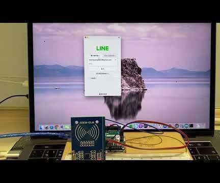

When you feel boring, you can try to make HC-SR04 with Arduino, it's very interesting!
(My ideas adapted from https://www.instructables.com/id/INTERFACING-HC-SR...)
This is an ultrasonic sensor project. When an object is close to it, the red LED will blink, when no object is close to it, the green LED will blink.
I add two LEDs and decorate my project.

Step 2: Setting Up LED
Use a long hookup wire to connect the 5V signal on the Arduino to the left of the red row on the breadboard.
Use a long hookup wire to connect the GND signal on the Arduino to the left of the black row on the breadboard.
Place red LED to the left of the breadboard, and green LED to the right of the breadboard.
Take resistors and solid-core hookup wire and connect LEDs to the breadboard.
Connect the red LED to pin 11 and the green LED to pin 12.
拿一條線,並連接 Arduino 上的 5V 到麵包板上紅色那一條線的最左側。
再拿一條線,連接 Arduino 上的 GND 到麵包板上藍色那一條線的最左側。
把紅色的 LED 放到麵包版的左側,綠色的 LED 放到麵包版的右側。
拿電組和線連接 LED 燈到麵包版上。
將紅色的 LED 燈連接到 pin 11,綠色的 LED 燈連接到 pin 12。
Step 3: Setting Up the HC-SR04
  • Connect Vcc to Arduino 5V
  • Connect Trig to Arduino pin 9
  • Connect Echo to Arduino pin 10
  • Connect Gnd to Arduino GND
