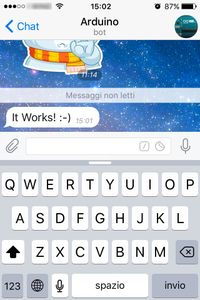

Step 2: Telegram
You have to create a bot, more documentation at https://core.telegram.org/bots
The simplest process is:
- add @BotFather
- write him /newbot and follow the instruction
- get the API key

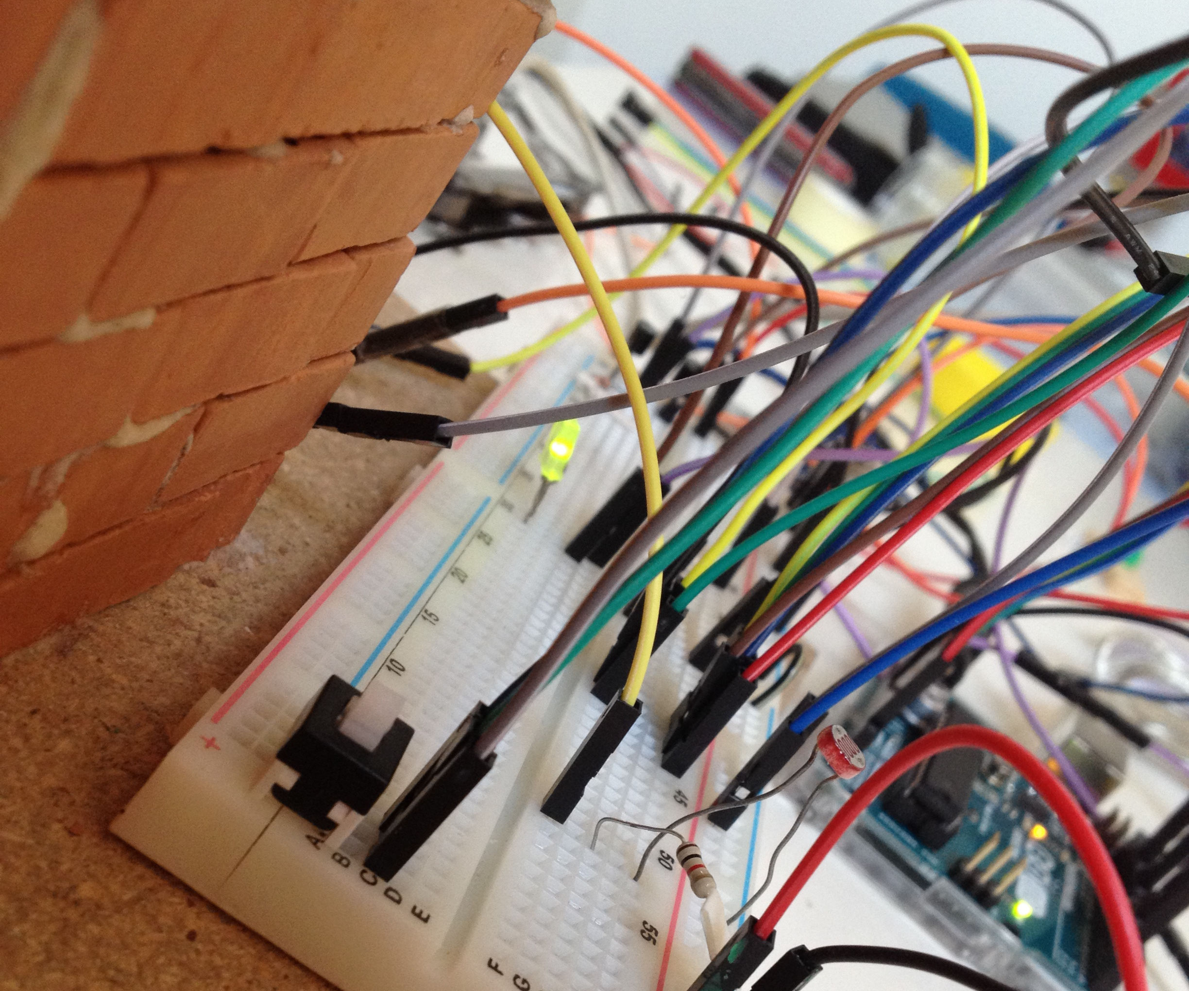

Now connect Arduino to a USB port of your computer, open IDE and get the name of serial port (something like /dev/tty.usbmodem314)
Download file attached!
open pyscript.py from the file you downloaded, write the correct keys and change the messages!

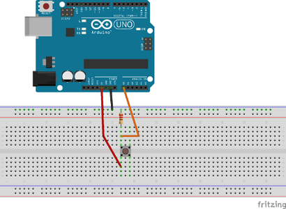

Complete the easy circuit, load Arduino.ino to your board and finally run python pyscript.py
