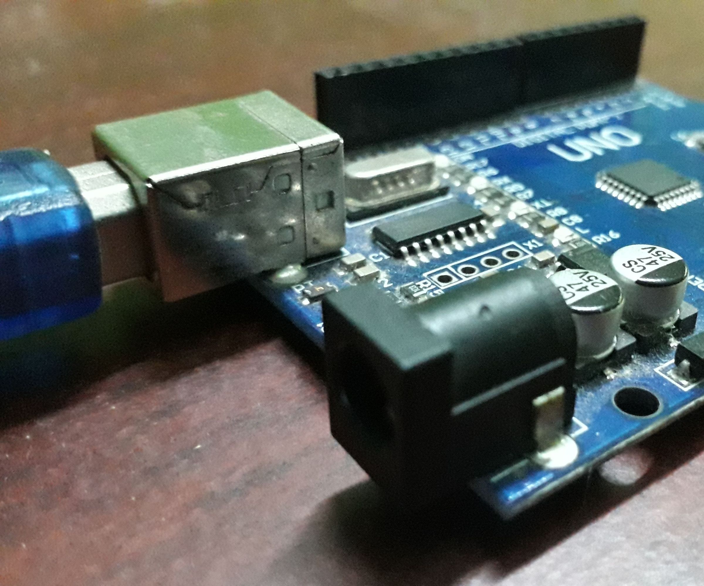

Step 2: Connections
Bluetooth >> Arduino
- vcc / 5v+ >> 5v
- gnd >> gnd
- RX >>D4
- TX>>D3
