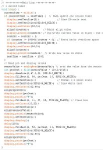

This is the main loop which does all the heavy lifting. The first half checks to see if it is time to update the second counter at the top right of the screen. Most of the time it skips the rest but every second it carries out the update. This is a very useful method of appearing to be doing two things at once, especially when one action needs to be carried out much more frequently than the other.
The second half reads the pot, calculates the percent value and updates the various parts of the screen. This is quite time consuming.
Please note that the whole screen is never cleared and re-drawn.
