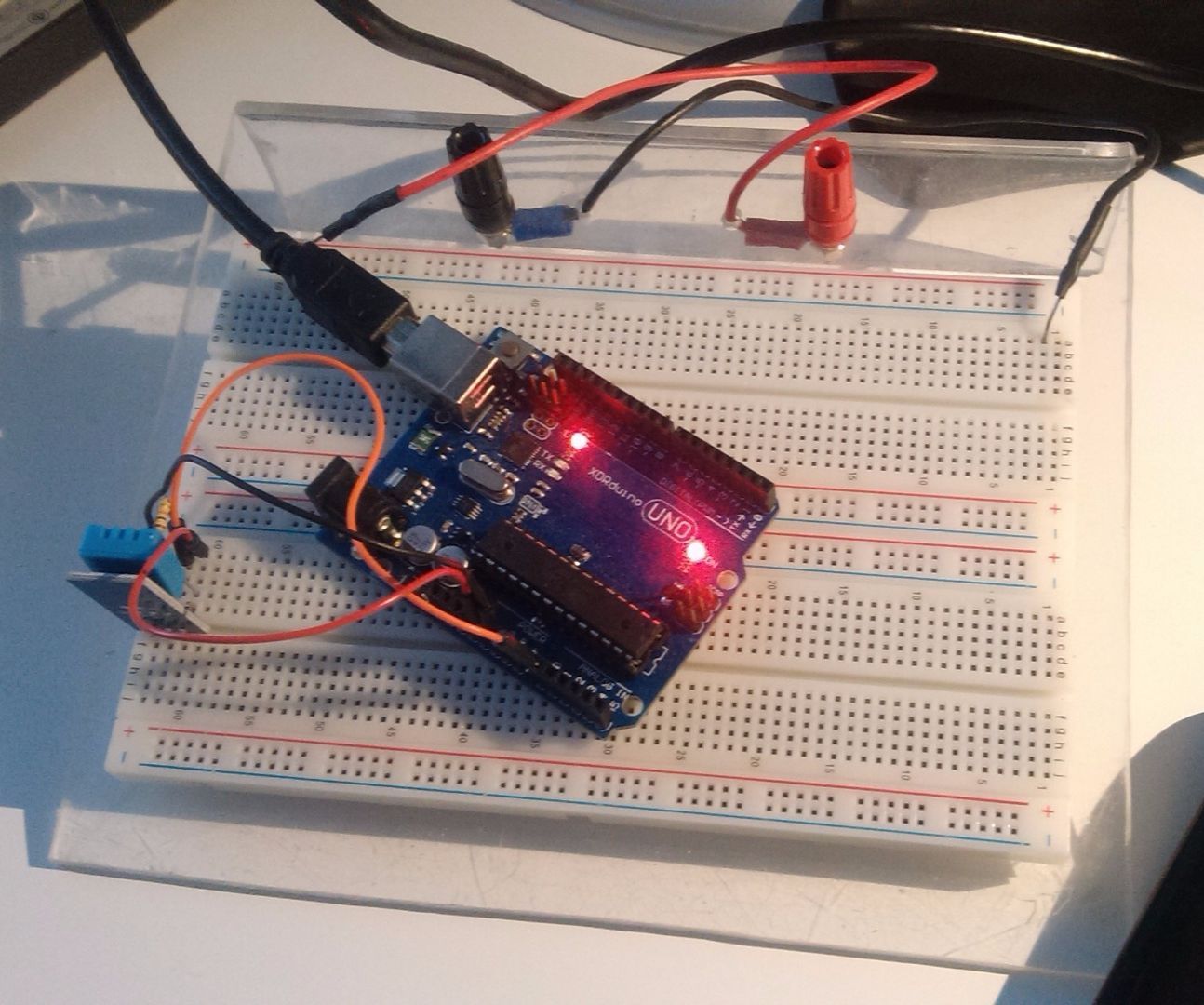

- Arduino Mega 2560
- Ethernet Shield W5100 with microSD slot
- Tiny RTC module
- RFID module RC522 with some tags
- 9V PSU and project housing
- Ethernet cable, breadboard and some wires
- LED (green and red or double colored) with 220 ohm resistor
- 8 ohm speaker (or buzzer)

Bloc diagram of our solution is presented in picture above. Central part is Arduino Mega 2560 platform. RFID reader, Ethernet shield and microSD card are connected to Arduino via SPI communication.Tiny RTC module is connected via I2C communication interface. Also we added LED and small speaker for indicating successful card read.
Step 3: Hardware Setup
Picture above is presenting connections among modules. For SPI communication we are using hardware SPI (MISO, MOSI and CLK are all the same, SS pin for Ethernet is on pin 10, for SD card is on pin 4 and for RFID reader is pin 6, and RST pin for RFID is on pin 7). LED is connected to pin 2 and 3, and speaker is connected to pin. Tiny RTC module is connected via I2C module to pins 20 and 21. 9V PSU is connected to Arduino’s external PSU connector. Ethernet shield is connected to computer (or router) via UTP cable.
