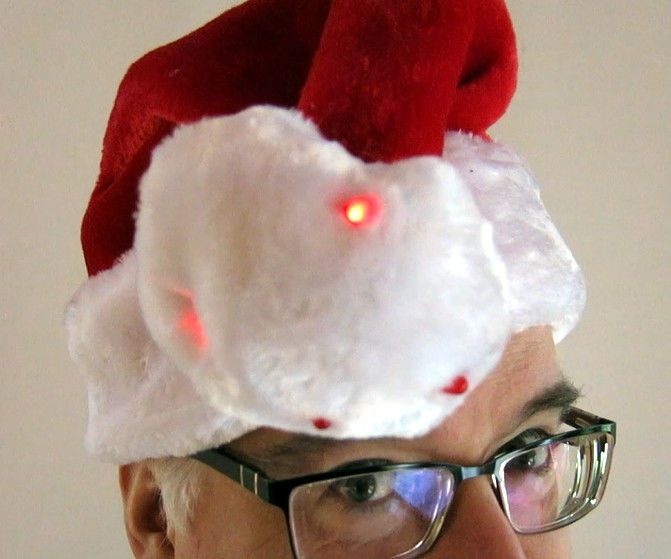

Step 3: Solder the 4 LEDs Into the Pom Pom
Push the leads of one LED through the fuzzy side of the pom pom into the inside.
Inside the pom pom, solder one end of a 100 ohm resistor onto the Positive (plus, anode) end of the LED (usually the longer lead, usually the one opposite the flat side of the LED lens.
Solder one end of a white wire to the other end of the resistor.
Cut the white wire to a length that will reach about 2/3rd of the way into the hat. This wire will eventually attach to an I/O pin on the Arduino, which will be inside the hat.
Slide a length of heat shrink tubing over the LED lead + resistor combination. Use a heat gun or (be careful) a match to heat the tubing so that it shrinks. Be careful to keep the heat away from the fuzz of the pom pom. If you don't the heat may melt the fuzz, ruining the look of the pom pom.
Solder a black wire to the Negative lead (minus, Cathode) of the LED. Cut the wire length to about the length of the white wire. This first black wire will eventually connect to a ground (GND) pin on the Arduino.
Repeat the process for the other 3 LEDs, except that instead of soldering a long black wire to the Negative lead of the LED, you will solder a short black wire between the Negative lead of this LED and the Negative lead of the previous one. That is, all the black (minus, cathode) leads of the LEDs are electrically connected to the one long black wire.
Step 4: Reassemble the Pom Pom
Insert the pom pom foam back into the pom pom and gather the fuzzy fabric around it, with the long wires (4 long white and 1 long black coming out of the part of the pom pom that will fasten to the top of the hat. Using the needle and thread and the hot glue gun, fasten the reassembled pom pom together.
Thread the 1 long black and 4 long white wires through the hole at the top of the hat. You may need to expand the hole to do this.
Use the needle and thread and the hot glue gun to securely fasten the pom pom to the top of the hat. The hat should now look a lot like it did when you bought it, except that it has 4 LEDs embedded in the pom pom.
