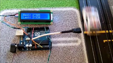

In this project I am using a custom-built infra-red proximity sensor connected to an Arduino board to time the laps on an electric car racing circuit. The sensor detects the car when it passes in front of it and measures the time elapsed since the previous detection. I have programmed it so that it also records and displays the best time.

The IR sensor is made of two identical IR LEDs. One is connected (red wire) to 5v through a 330 ohms resistor and casts IR light. In my setup it is connected to digital output pin 12. On the picture you can see the LED shining because digital cameras are sensitive to IR light. With bare eye you would not see it. The detector led is connected straight to the analog input pin A0 (yellow wire). The ground (black wire) is common to the two LEDs and is connected to a ground pin on the Arduino.
The two LEDs are wrapped together with heat shrink wrap and are mounted in a parallel position. The emitter casts IR light. When an obstacle (in our case the car) is in front of the sensor, it reflects the IR rays. The reflected light hits the detector LED, which, as a consequence, produces a small current. The current is fed to an analog input on the Arduino board and, due to the internal resistance of the board, produces a voltage that can be measured. The closer the obstacle, the higher the intensity of the reflected light and the higher the voltage value read.
The loudspeaker (optional) is connected to one digital PWM pin (number 3 in this case) and to the ground.
The LCD display (optional) is connected to 5v, ground and to the SDA and SCL pins. In the Arduino UNO Rev. 3 these are two dedicated pins placed next to the AREF pin. In earlier versions analog pins A4 and A5 must be used instead. To drive the LCD screen I use the new LiquidCrystal library of fmalpartida, which replaces the stock Arduino LiquidCrystal library.
