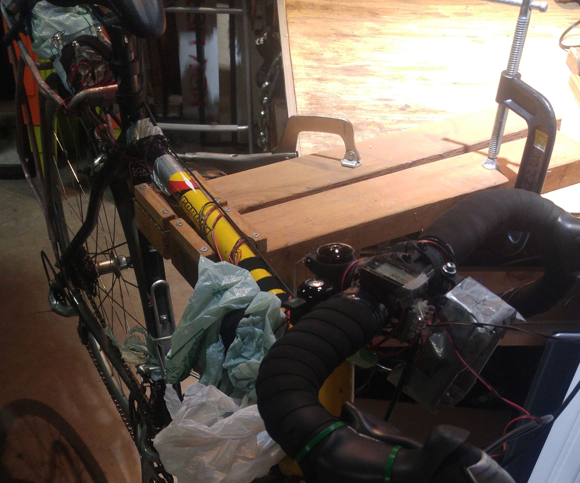

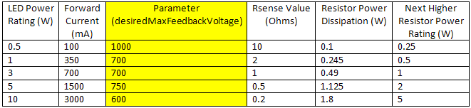

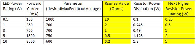

The Arduino is used to monitor the LED current, maintain the LED current for each channel, read the momentary switches for brightness control, and detect overvoltage. When the LED current flows through Rsense, there is a voltage drop. The Arduino maintains it between 0 and 1095 mV depending on the feedback voltage setting. The LED current is equal to Vfeedback/Rsense. There is one brightness control switch for each channel. The channels have 10 levels of brightness and each press increments the brightness by 10% of the maximum current you have set it to. When one of the boost channels have overvoltage, Q5 turns on and the D0 input is pulled low. This sets the channels' duty cycles to the lowest.
In the sketches, you can modify the maximum duty cycle, operating frequencies, and feedback voltages, and select boost or buck mode. The higher the duty cycle, the higher the current. The operating frequency is the frequency of the Arduino's PWM output. It has nothing do with PWM dimming. If it's higher, you can use smaller inductors. If it's lower, you have have a smaller duty cycle because resolution increases. The LED current is equal to the feedback voltage divided by the Rsense value. Refer to the table for the feedback voltages and the sketch for more instructions. If boost mode is selected for a given output, the waveform will be inverted.

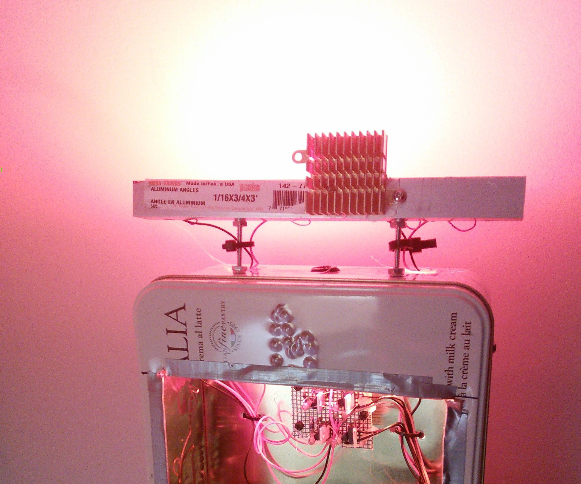

  • Grow lights
