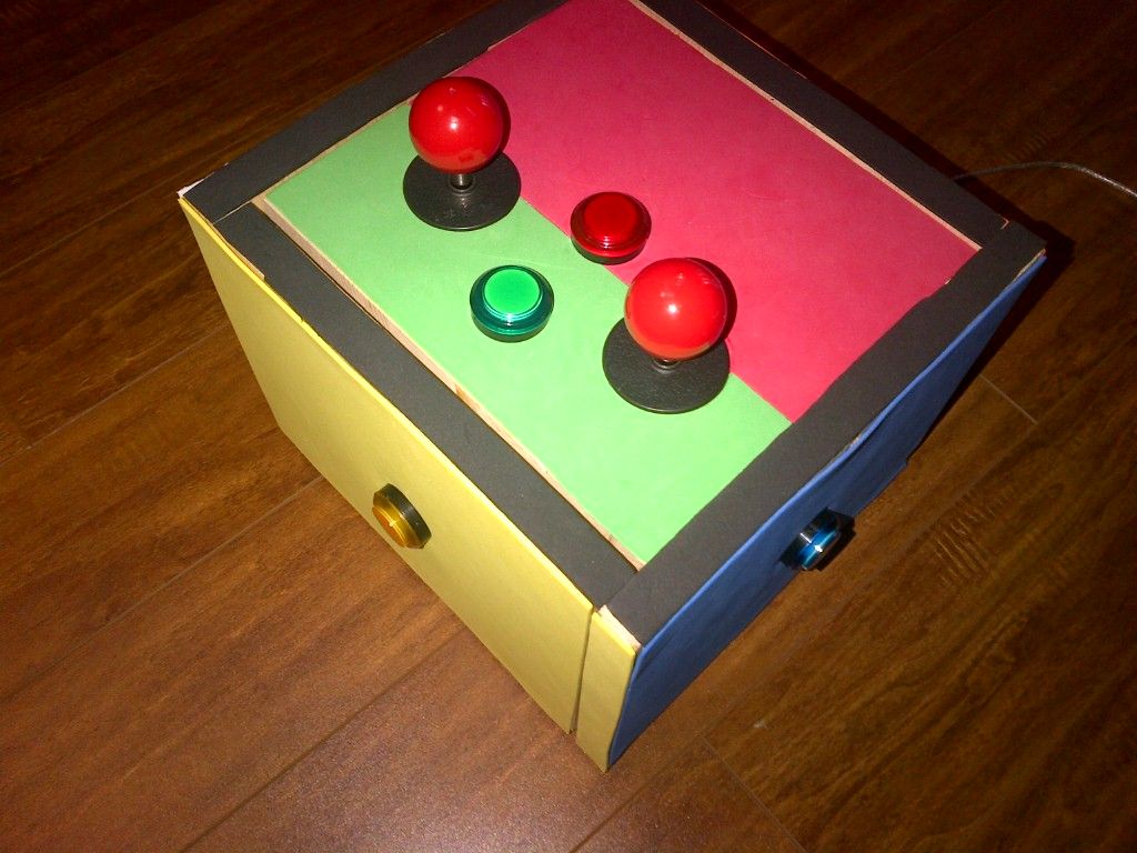

Step 1: Box Design and Colour Scheme
Created button holes for the side panels of box.
Added styrofoam colour panels to each of the sides.

Step 5: Completed Project
Picture and video of completed project.
The power source is the built in USB connection for the Arduino Uno.
