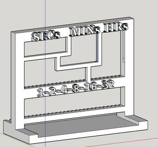

Step 4: 3D Print and $5 Solar Cell! Coming Soon!
Here are pictures of the initial development for the 3D printed "minimalist" frame and the $5 solar cell.
I'll post them in separate instructables link will be added below soon!
