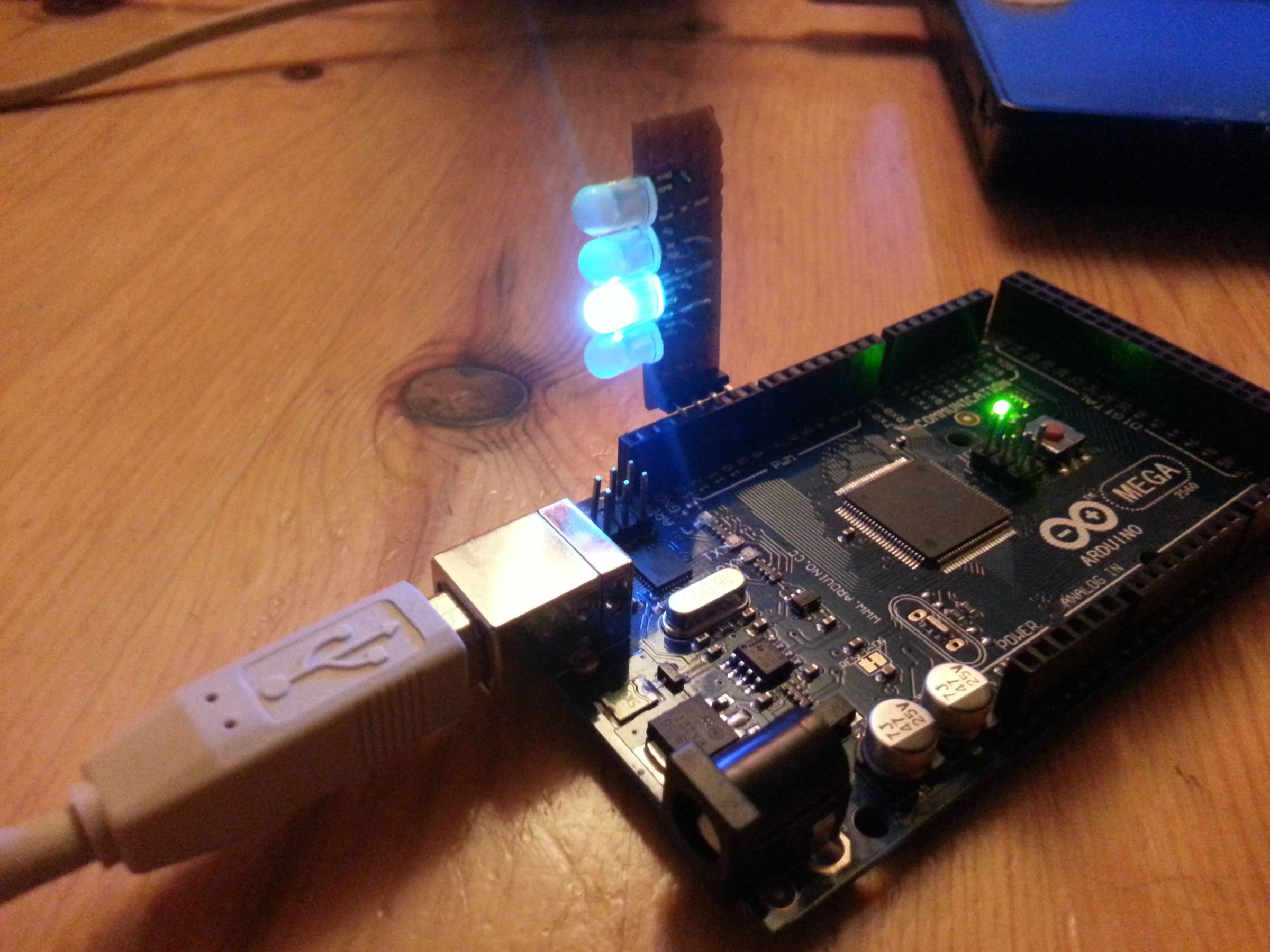

Step 1: (optional) Wiring and Power-up (only for DS1307 Breakout)
The wiring is very trivial, just pluging the DS1307 real-time clock breakout to the pins A2-A5, leaving the "DS" pin in the air (From Homebrew Computers), please wait with the connection, until the pin power-up is verified. If you don't have a DS1307, just use any other I2C device you have.
The power will be supplied over the pins A2/A3:
- Download [GitHub] and Unzip
- Rename the directory to "MiniPirate"
- Compile and download the sketch on you Arduino
- Open the Serial Monitor in your Arduino IDE ("Tools -> Serial Monitor")
After opening the monitor the help and the first prompt should be displayed. Now we execute the first command. Just type 'p' and hit <enter> in the top line of the Serial Monitor. This will show the current configuration of all ports (INPUT and Floating values).
To set A2 to Ground and A3 to Vcc wie execute: \a2/a3 <enter> and control the result with 'p'. As we don't want to repeat this again and again, we save it with 'x'.
Now we can plug in the module as described above.
