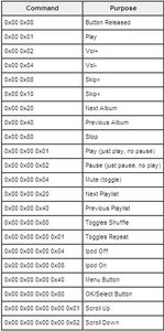

Basic comunication protocol. Dont worry, everything is in the code file.

byte mode2[]={0xFF,0x55,0x03,0x00,0x01,0x02,0xFA};//mode 2 command
byte nobutton[]={0xFF,0x55,0x03,0x02,0x00,0x00,0xFB};//button release command
int release=200;
//commands
byte playxpause=0x01;
byte nextsong=0x08;
byte prevsong=0x10;
byte shuffle[]={0xFF,0x55,0x04,0x02,0x00,0x00,0x80,0x7A};
int long time;//
int butbefore=1023;
int dockbef=0;

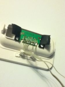

Solder the ipod dock
Solder the arduino cables
Solder pushbuttons and resistors.

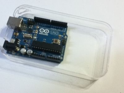

Step 6: Place It in a Box
I used my ipod touch box.
You can also add some leds. Its all up to you.
