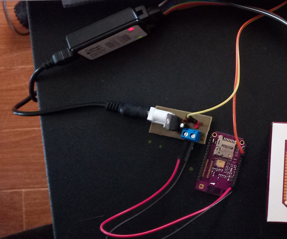

Step 1: Making the Shields
The shields were made using the Toner transfer method, but any method would do. They were coroded using Feric Chloride.
1. The RTC
The first step for me was to make the RTC shield. If you are lucky you allready have one and you do not need to make it.
The schematic was made in Eagle and can be found in the download files.
As you can see, the shield has a battery holder (so that the time will be remembered if the power goes out). An Cr2032 battery is what I have chosen here. Also there is an variable resistor that can be used for an LCD, but in my project I did not used this one. It is there just in case I need it for some other project. There is also a reset button that can be put here to reset your Arduino in case you need it.
2. The relay shield
The relay shield can be seen in images before being coroded and after it was partially mounted with the electronic parts. The shreded paper is shreded just because I could not wait for the glue to harden and I used a cutter that was just not sharp enough :D.
The schematic and the board layout are in the attached files.
