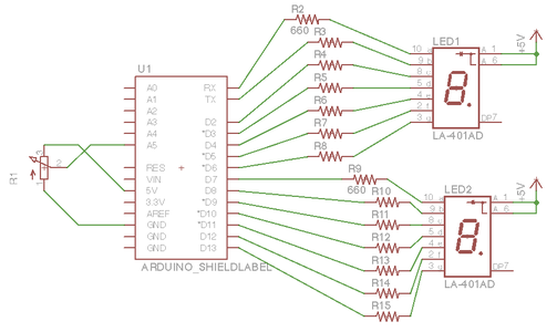

Step 2: Circuit
This is the way a 2 digit common anode display would be attached. Common anode means that all the led's share a common power supply. So in order so turn one on, the pin will be set to LOW.
KEEP TRACK OF WHAT WIRES GO TO WHAT LED! You're going to use that information to build the port mapping later.
A potentiometer is added just in case you want to get fancy and have the pot control the number instead of just counting up. This is not too much more difficult, so go ahead and try it.

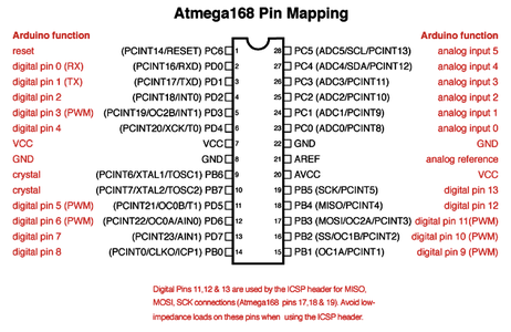

Step 3: Port Manipulation Mapping
This is the pin mapping for the arduino uno. Notice that each port there is a designation right next to the pin that looks like "PX#". This is the pin number for that letter bank. There are multiple banks in this chip. The ones we care about are bank B and D. They are the ones to be manipulated. Write down the pin and corresponding port bank id for all the leds. The next part will be to combine them.
