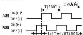

This is exactly the same as before except for the addiction of the rotary encoder. The encoder has four connections; Vcc, ground, OutA, and OutB.
OutA is the main pulse control and is what will trigger the interrupt. OutB functions as the direction pulse and indicates relative direction when used in conjunction with OutA.
What is going on is that both OutA and OutB are sending regularly spaced pulses but are out of phase with each other. This phase change is what allows the encoders to determine direction.
Look at the diagram of the pulses. The interrupt is set to trigger when OutA sends a Rising signal. The state of OutB is then read. If the state is High, then that means that it is turning clockwise. If the state is low, then the only way that could happen is if the pulses were being sent in the opposite direction or counter-clockwise.
