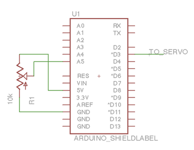

Step 2: Circuit
This circuit is just about as easy as easy gets with an arduino powering it.
The servo has three wires, Vcc, ground, and data. Connect Vcc to power, ground to ground, and data to pin 3. The data pin is important because it needs to be a pin with PWM or pulse with modulation control. Not all arduino pins have this capability. On the uno they are marked by a " ~ ".
Connect the potentiometer to power and ground. Connect the third leg to analog pin 5. This creates a variable voltage divider for the arduino to read.
Circuit complete.
Circuit complete.
