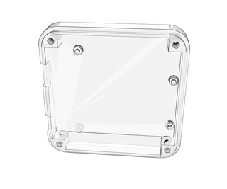

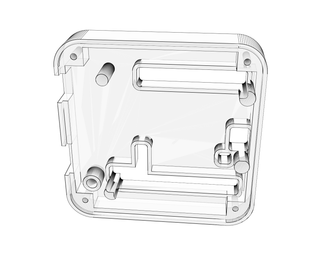

Step 3: Print the Arduino Case (optional)
I printed an Arduino case so the Arduino won't get damaged inside the bin. I added the files so you can print them if you want. I got the files from this Thingiverse project: http://www.thingiverse.com/thing:628929
