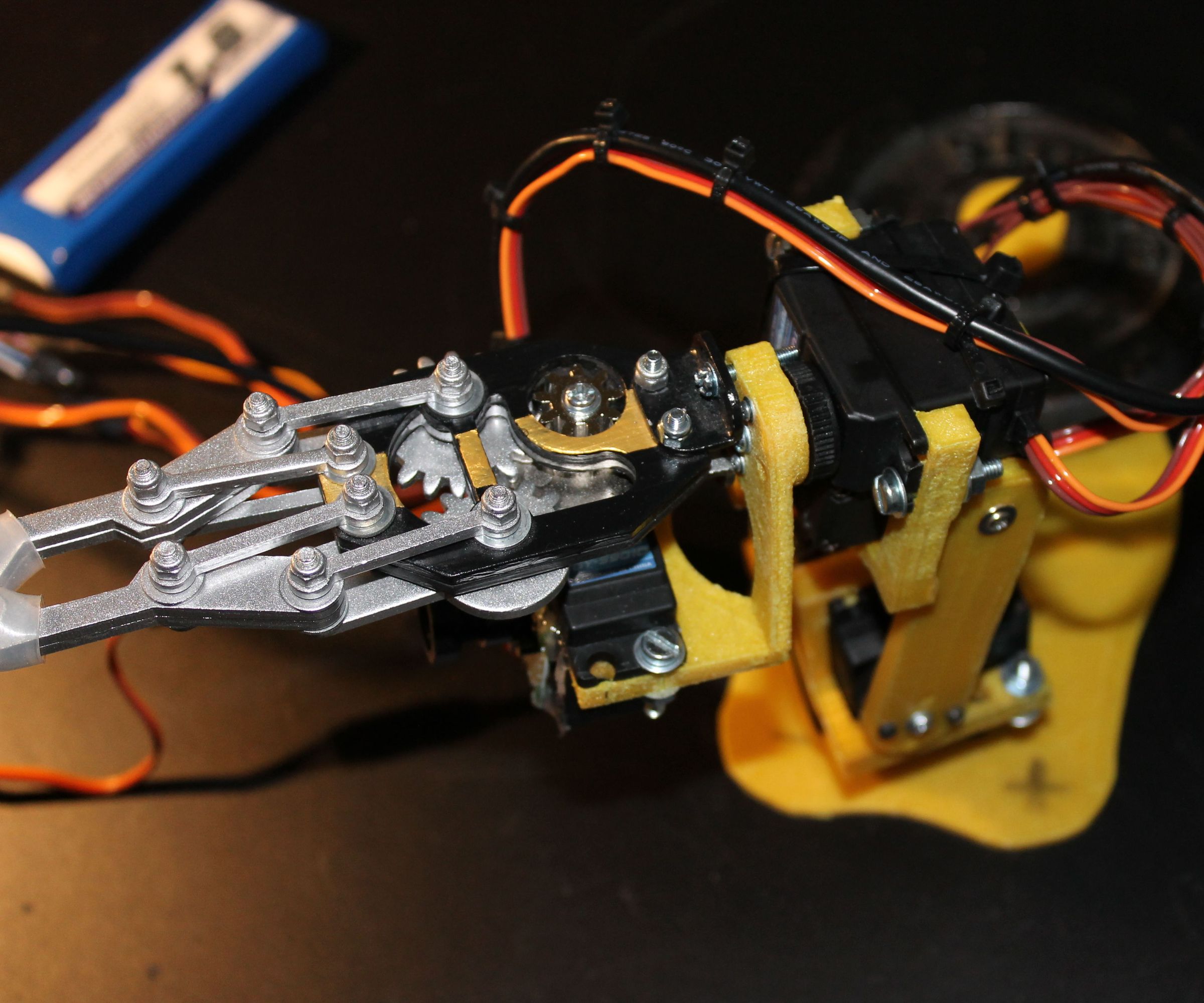

DD-9602 is my new robot. It is a robotic arm fixed on mobil base.
It has 4 servomotors and two motors DC to control the base. The robot is controlled from RC controller, but using Arduino we can control also movement on the ground.
I bought the component from HobbyKing and other site.

You must assemble the chassis following the instructions.
You complete the arm with screw, bolts and threads
rods. Attach the gripper to the arm.
Step 4: Union of the Arm With the Base
The motor shield is connected to a DC motor (motor A: cable red +, cable black -, motor B: viceversa).
The Rx has 6 channel, the first two are connected to Arduino, the others are directly attached to the servo motors.
