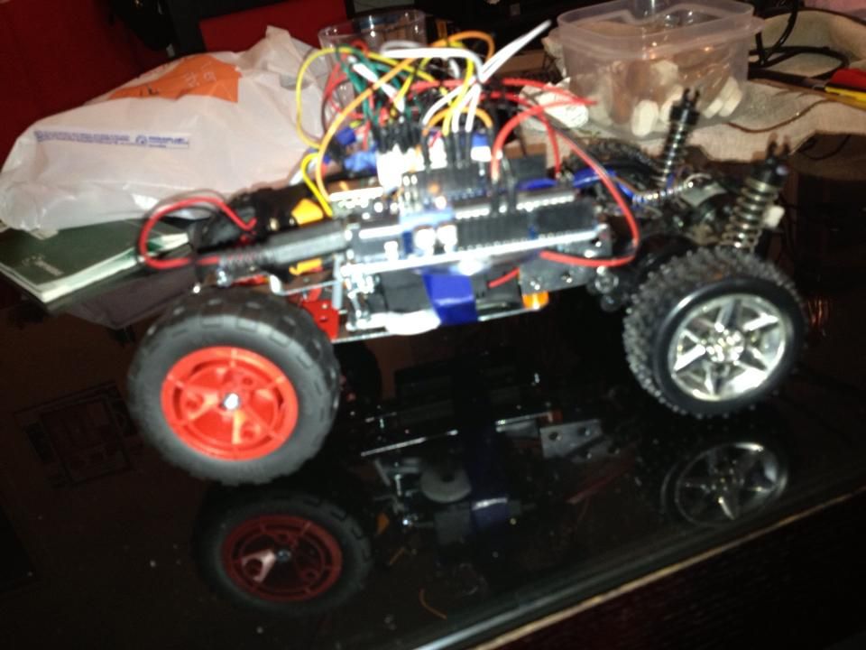

Arduino simple hand motion.
Detect hand motion direction and speed.
Can be used to control any device... I let you the magic imagination

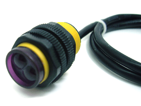

You will need:
-1 *Arduino (Uno)
-3 or 5 or ... IR switch ( I used E18D80NK) ( 6€ )
-wires.
-3* 1k resistors
- 3* LEDs.
