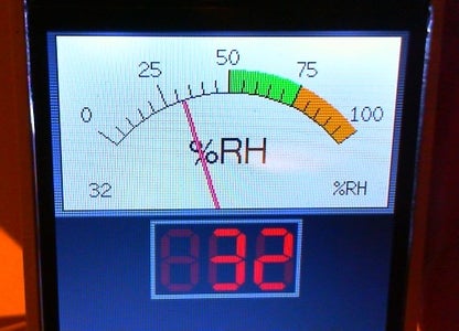

Displaying small digital numbers of temperature and humidity etc on a tiny screen is not always the best way to show information. The old style analogue meters are better in some situations and are great for a quick visual check of a sensor reading from a distance, they are also a good way of showing trends. So here we have a retro looking analogue meter on a modern TFT display, complete with smoothly animated needle!
I've pulled together a couple of functions in a demo sketch here for digital and analogue meters. I have not got around to "parameterising" the functions, so at the moment it is not easy to draw the meters anywhere on the screen with defined size and scales, but if there is sufficient interest (and given time!) I will try to do this at some point, in which case this Instructable will be updated.

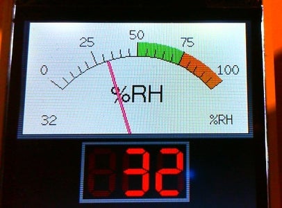

The analogue meter has a moving needle that sweeps slowly with configurable speed to show the new value of a variable. The value in this example is in the range 0 to 100 (I used it for showing humidity). Meter labels can be changed easily. The actual new digital reading is shown in the bottom left corner of the meter. Needle end stops are emulated for readings outside of the normal range! Coloured zones can be added to show comfortable ranges etc.
Tip: The needle flicker is minimal but removing the units display from the needle sweep zone will improve things (and also mean that Font 4 does not need to be loaded, saving FLASH space). Just two lines in the sketch (156 and 200) need to be commented out, use the new Arduino 1.6.0 IDE and switch on line numbering to help find them!
The digital meter uses a 7 segment font and shows a dim image of the unlit segments to try to emulate the look of a real 7 segment display! The colour could easily be changed, perhaps with the value as in my Instructable here.
