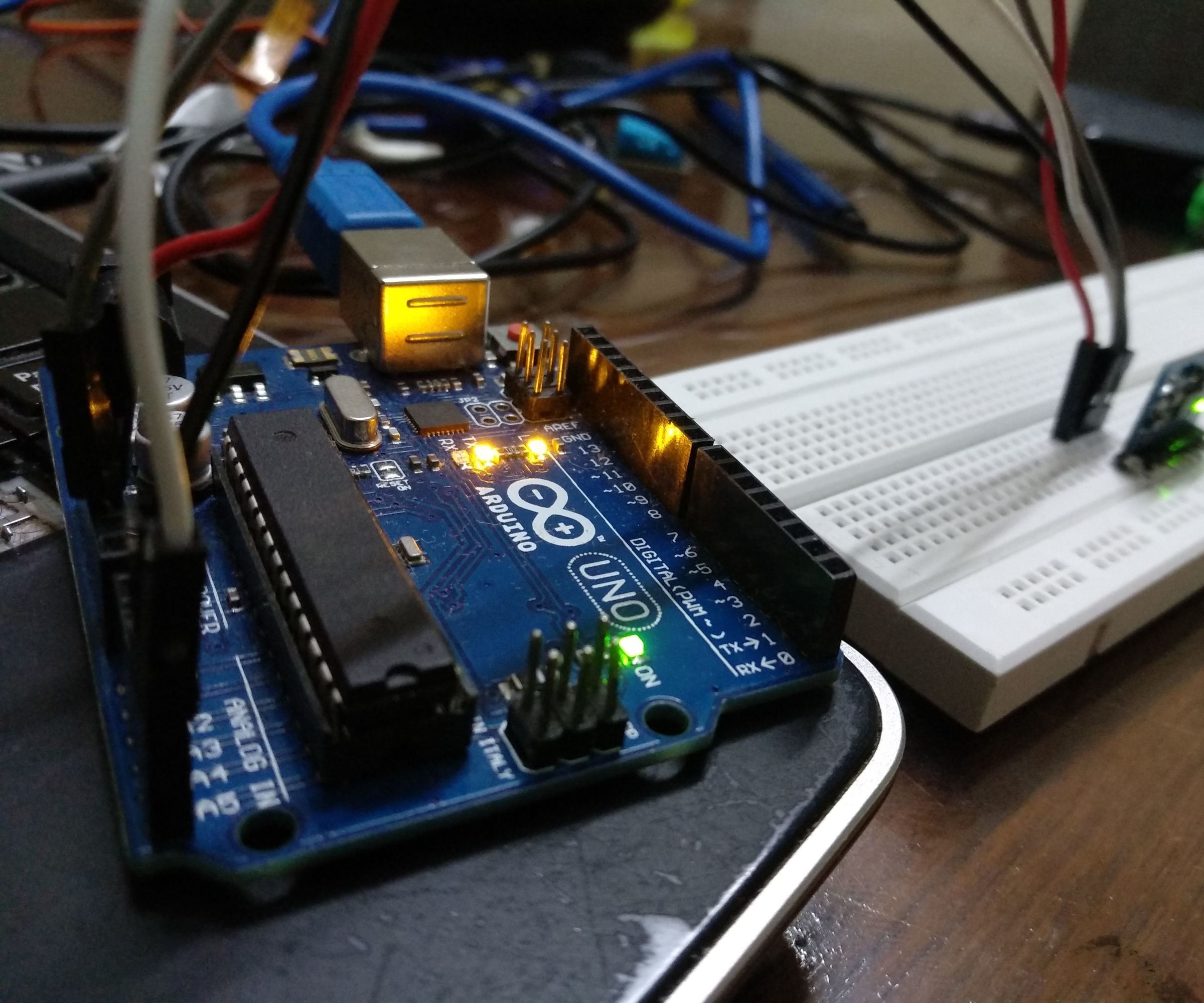

We are using the Arduino Uno for this example, it will be transmitting the message, 0 and 1 are the serial ports for this board
In serial communication, The TX of one board goes into the RX of the other and vice versa.
The connections are very trivial and can be seen in the picture
