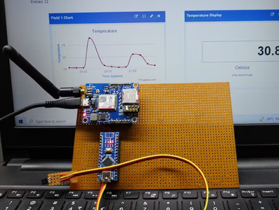

In this project, LM35 temperature sensor data is being transmitted to the ThingSpeak platform through an Arduino Nano and a SIM800 module. The SIM800 module is leveraged to establish a GPRS connection, facilitating the transmission of data to ThingSpeak at specified intervals.
To ensure a reliable connection between ThingSpeak and the hardware, users must configure the SIM800 module to establish a connection with their mobile network. This configuration encompasses setting the Access Point Name (APN) specific to their mobile carrier. It's important to note that the specific AT commands for this configuration may vary based on the user's chosen mobile network provider.
For this project, I utilized the services of the network provider Airtel to establish the connection.
Communication between the hardware components, specifically the SIM800 module, Arduino Nano, and ThingSpeak platform, relies entirely on AT commands. To ensure successful project implementation and effectively troubleshoot any issues that may arise, users must possess a basic understanding of SIM800 AT commands. This knowledge is crucial for configuring, managing, and diagnosing the communication process and resolving potential challenges during the project.

Connection Diagram
Establishing Communication Between Arduino Nano, SIM800, and ThingSpeak (Serial Monitor Data Captured During Project Execution).
AT+CSTT="airtelgprs.com"<CR>
OK
AT+CIICR<CR>
OK
AT+CIFSR<CR>
100.78.215.26
AT+CIPSPRT=0<CR>
OK
AT+CIPSTART="TCP","api.thingspeak.com","80"<CR>
OK
CONNECT OK<CR>AT+CIPSEND<CR>GET https://api.thingspeak.com/update?api_key=5XC1TCVONJVK1PNN&field1=20.00&field2=10.00
GET https://api.thingspeak.com/update?api_key=5XC1TCVONJVK1PNN&<SUB>
SEND OK
6
CLOSED
<CR>AT+CIPSHUT<CR>Temperature = 20.00 °C
Humidity = 10.00 %
SHUT OK
