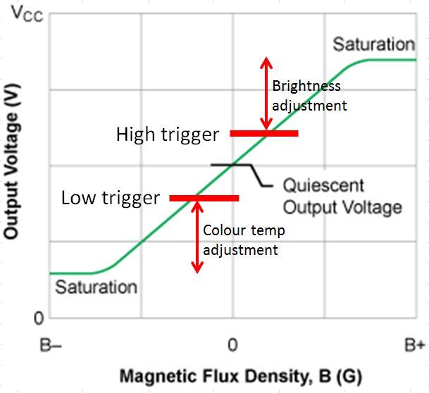

For the product control/interaction I was looking to come up with something a little different, not just a dial or something.
After a bit of research into different types of electronic components, I found linear radiometric hall effect sensors. These are basically a sensor that's output is affected by magnetic fields. Usually the sensors output is half the input voltage. However when a magnet is brought near it, the output will either rise to the input voltage or fall to 0V (saturation limits) depending on whether its the north or south pole of the magnet.
I realised I could utilise this to allow me to control two different settings on a single hall sensor - the 'puck' idea was born. A magnet is hidden in the laser cut puck and would control either brightness or colour temp depending on which end was facing the sensors. I go into the Arduino code later, but essentially I read these sensors and look for whether the output has risen above a 'high trigger' or fallen below the 'low trigger'. I use multiple hall effect sensors to allow me to map a specific colour temp and brightness value onto each, which get triggered as you slide the puck around the arc..

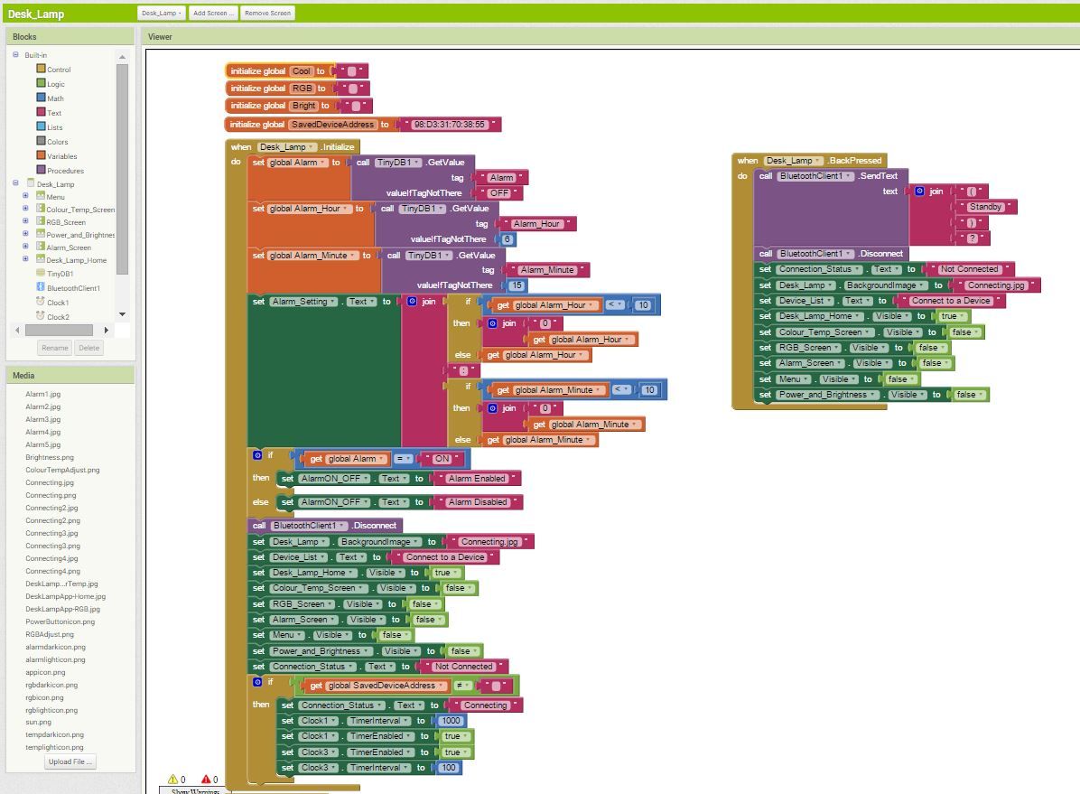

Once the visuals are setup, its time to switch to the 'Blocks' tab and write the code. I'll describe it in brief, buts its probably easier if you import my file into App Inventor and have a play around yourself...

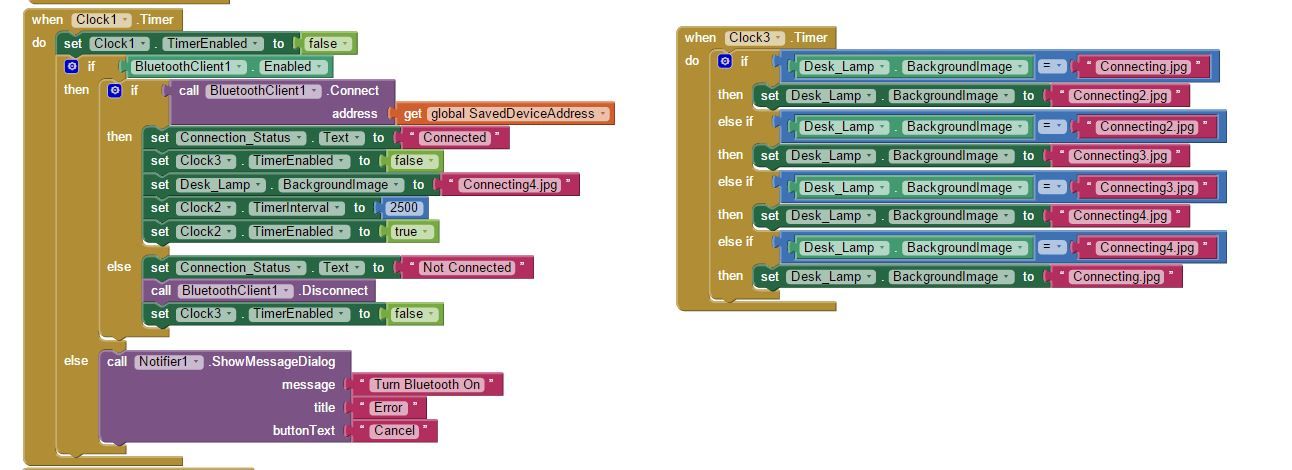

These first blocks are for the connection screens. To allow the App to try automatically connecting to the Arduinos bluetooth module I create and set a variable to the address of my HC06. I use a timer to change the background image whilst it is connecting. If connection is successful then it loads up the colour temp screen. If the bluetooth fails to automatically connect, you need to press the 'connect to device' button. This will bring up a list of all the bluetooth devices your phone can see. The 'bluetoothclient1.connect' command uses the device address you select from that list to connect with.
These blocks control what happens when you touch each of the menu buttons - change between RGB, colour temp and alarm. As they're touched the applicable visual layers are turned on and off. I.e when you tap the RGB menu button it switches the background image of the buttons canvas to the dark icon, turns on the RGB screen and the other off.

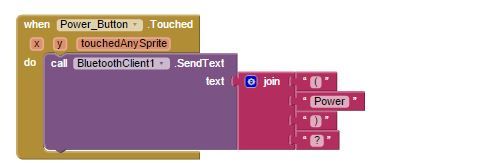

The power and brightness control is shared between the RGB and colour temp screens. In order for the Arduino to know which LED's to control, I need to tell it which screen is loaded. A text string in the format (screen)? is sent by your phones bluetooth using command BluetoothClient1.SendText.
This block sends the string (Power)? whenever the power button is tapped.

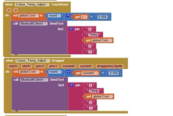

These blocks control the colour temperature adjustment. When you touch the canvas, the Y coordinate of your touch point is used to set the variable 'cool'. The Y value is driven by the pixel size of the canvas, so in my case a value between 0 and 450. I use the multiplier to convert that into a usable PWM value (0-255). I then send a string with that value and an identifier in the form (Tempvalue)?.

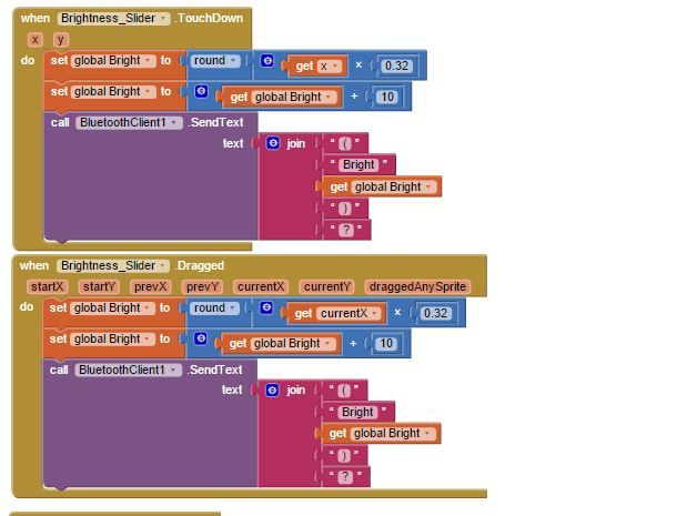

Similar blocks as above but for the brightness control. Using the X coordinate this time and different multipliers to set the variable 'Bright' to a value between 10 and 100.

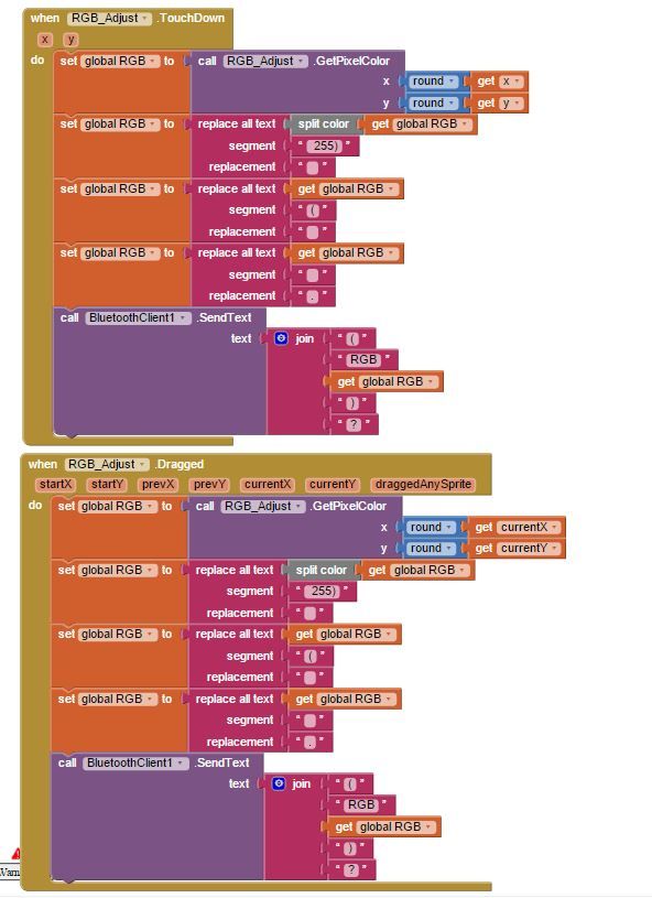

These blocks are for the RGB control. There is a command called 'GetPixelColor' that can be used to get an RGB value of pixel your finger is touching. It outputs the value with an extra 255 at the end for some reason, so I do a bit of work to get the value into the format (RGBredvalue.greenvalue.bluevalue.)? Again this is then sent to the Arduino, but with RGB as an identifier in the string.

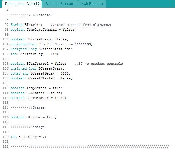

First I setup all my variables, assigning the sensors and LED's to the correct pins. The output from the hall effect sensors will be read using the analogRead function, giving a value between 0 and 1023. As previously described it outputs half when no magnets present, so around 500. I use Low and High trigger variables to allow me to easily adjust when it knows the puck is over the sensor.
The neopixels require a library so thats defined here..
The void setup starts the serials, for the Micro the Rx/Tx pins (bluetooth) use Serial1.. The pins are then set to be inputs or outputs and LED's set to off.

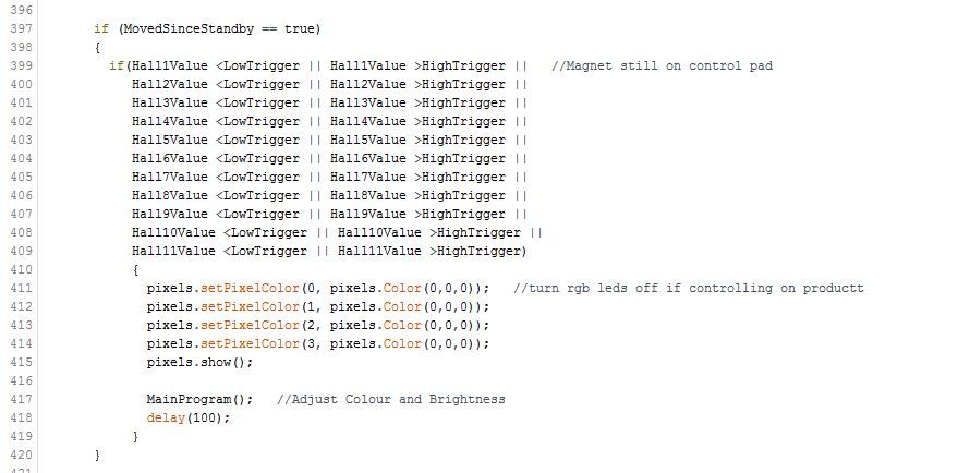

The code for the puck now.. First the sensors need to be read.

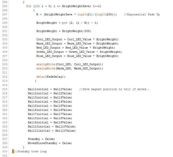

If the light is currently off, it will check whether any of the sensors are above or below the trigger points i.e the puck has been placed on the arc. If it is then it will fade up the white LED's to your last setting no matter where you place it.
To keep the LED's set to your last setting instead of updating to the values associated with whatever sensors its triggering, the MovedSinceStandby variable is set to false. This next bit of code basically checks whether you've moved the puck from its initial position by a set amount....
If you are moving the puck the 'MainProgram' is called to update the brightness/colour temp. This is described further down.

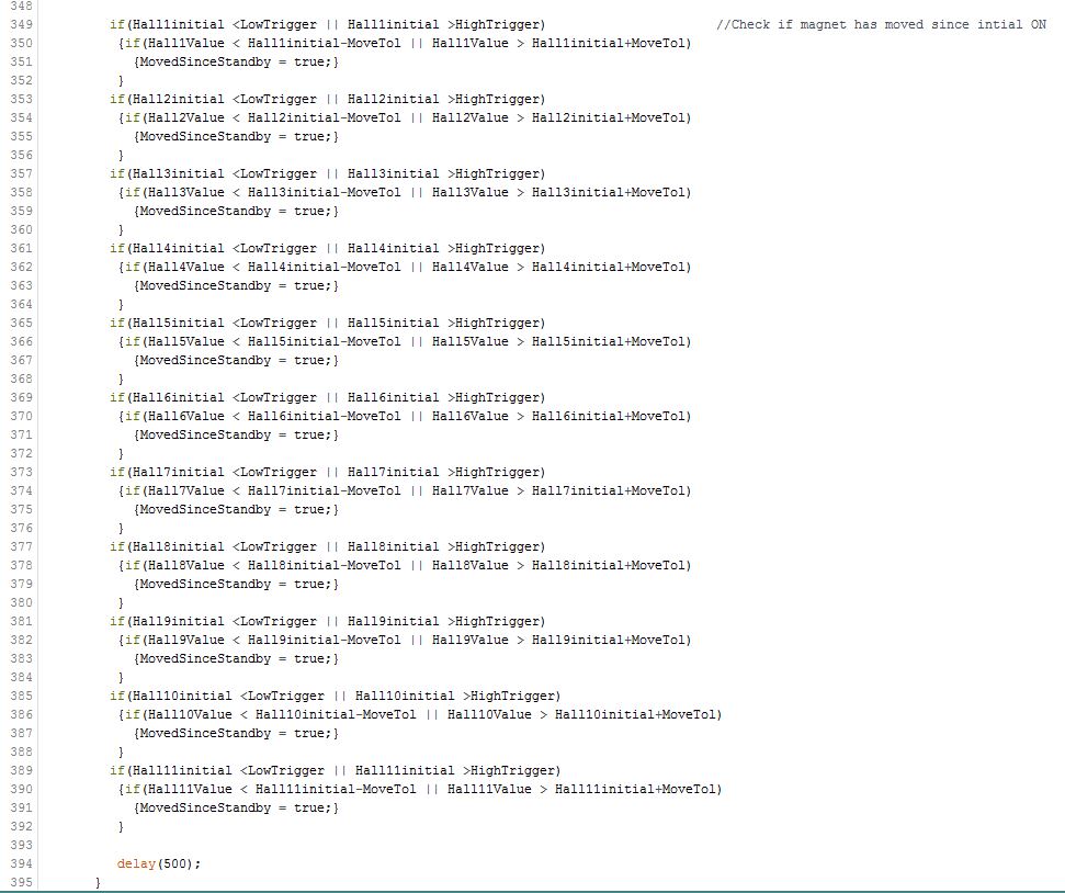

The last bit in this main loop checks whether the puck has been placed back on the standby dock - is sensor 12 reading a value above/below a trigger point. If so it fades the LED back down..

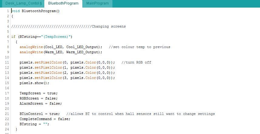

The bluetooth loop:
As described above when data is received via bluetooth, the string is read. We now need to check what that string says...
All strings apart from brightness, colour temp and RGB are quite easy to deal with. You check whether BTstring is equal to the text sent from the App.
If you recall, whenever you change screens in the App it will send a bluetooth command. Here we question for that and set some variables to true or false so we know which screen you're on.
Notice at the end of each section I set the BTinControl variable to true and clear the BTstring value.

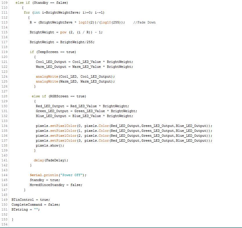

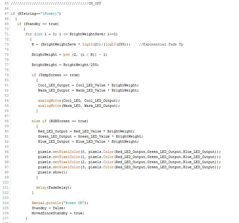

When you tap the power button in the App it will fade the LEDs up or down. The variables set above for which screen you're on are used to decide whether its the RGB or white LED's to control..

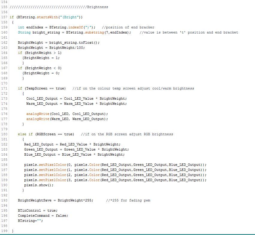

For brightness, colour temp and RGB I need to read the strings in a slightly different way. Because the number part of the string will be changing I question whether the string starts with one of the identifiers not the full string, so just (Bright here..
I now need to separate out the actual brightness value from the string. The format of the string sent from the App is (Brightvalue) so I therefore know the brightness value will be between the 't' and the ')'. The position of the 't' will remain constant, it will always be the 7th character in the string. But because the brightness value can be between 10 and 100 the position of the ')' will change. I use the .indexOf command to work out where the ')' is, what character it is and can then use the .substring command to read the string between the 7th character and the ')' character position. This leaves me with just the brightness value which I can use to adjust the RGB or white LED's depending on screen.

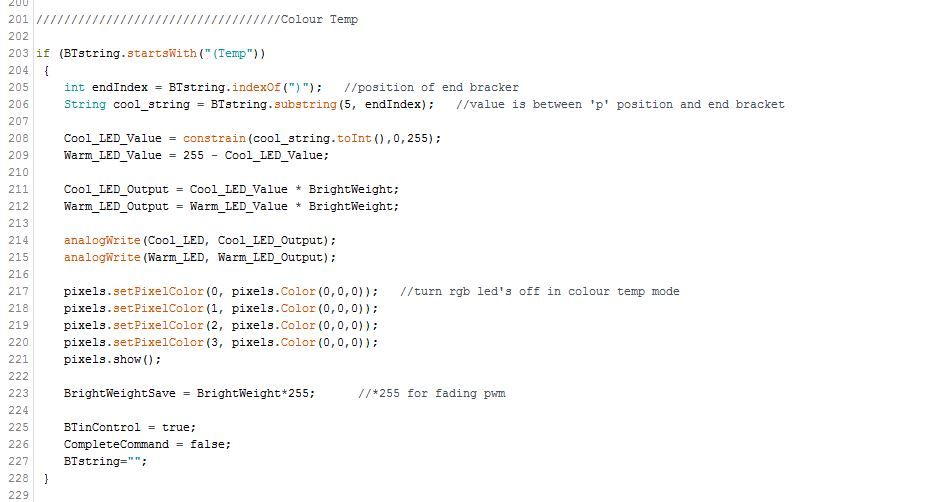

Colour temp adjustment is a similar process to above but the value will be between the 'p' and the ')' this time...

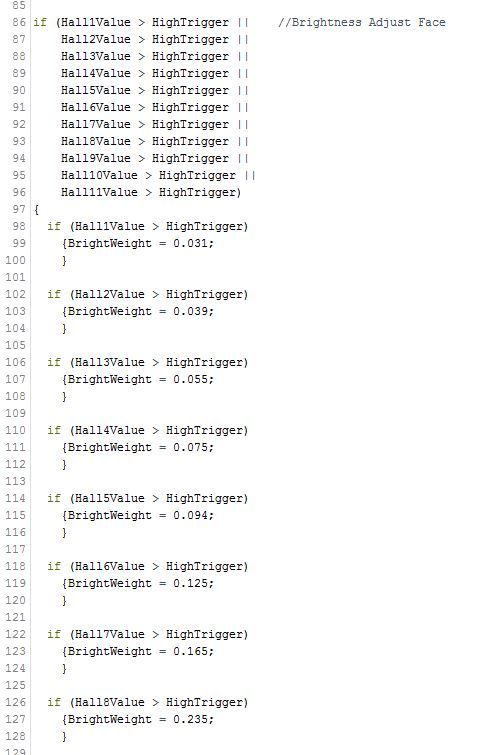

As described before if the puck (magnet) is one way up it will drive the hall sensor output below the low trigger and if the other way up above the high trigger.
This allows control of both brightness and colour temp on the same arc..

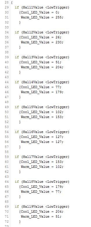

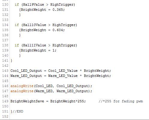

The sensors values are read. If any of them are less than the low trigger value then we are adjusting colour temp. There are 11 sensors under the arc area, which outputs will in turn go below the trigger point as the puck is move over them. Each sensor has a PWM value for the cool and warm LEDs against it, starting with sensor 1 at 100% warm, 0% cool and working to the 11th at 0% warm, 100% cool.
The brightness control is done in the same way.. checking if the sensors outputs are above the high trigger this time and giving each sensor a brightness weighting value.
This brightness weighting is then multiplied with the colour temp value to give the overall output value. Allowing you to set any colour temp to any brightness...

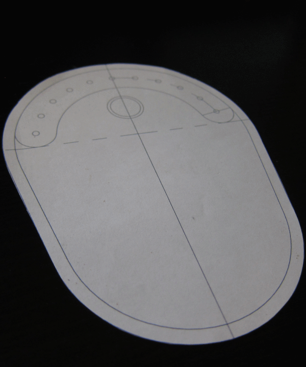

Step 5: Housing
- I started by making a mold out of cardboard for the lower part of the housing. To create the recesses for the control area I had a piece of plywood laser cut into the arc shape and used a 5p coin for the 'standby' dock. These were glued down to the cardboard mold, paying attention to get them in the correct position that would align with the hall effect sensors.
- Next was to mix up the polyurethane resin. The stuff I use has a simple 1:1 ratio and cures within about 20mins.. so need to work fairly quickly!
- The initial pour was to fill the bottom of the mold. After this set I added an inner wall of cardboard to allow me to pour the side walls.
- To create the upper section, that the LED's would sit in, I cut and glued some plastic tube/cup in place at an angle. And again the resin was poured in and allowed to set.
- Now the housing was all set, I needed to drill out some holes and give it a good sand down.
- Primer was applied and then sprayed with the final top coat of paint.

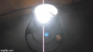

Overall the light works pretty well! There's a few bugs in the software to iron out and the RGB LED's could be brighter. I may also add an ambient light sensor to automatically change the colour temperature, starting 'cool' during the day and changing into 'warm' at night.
Cheers for reading!
