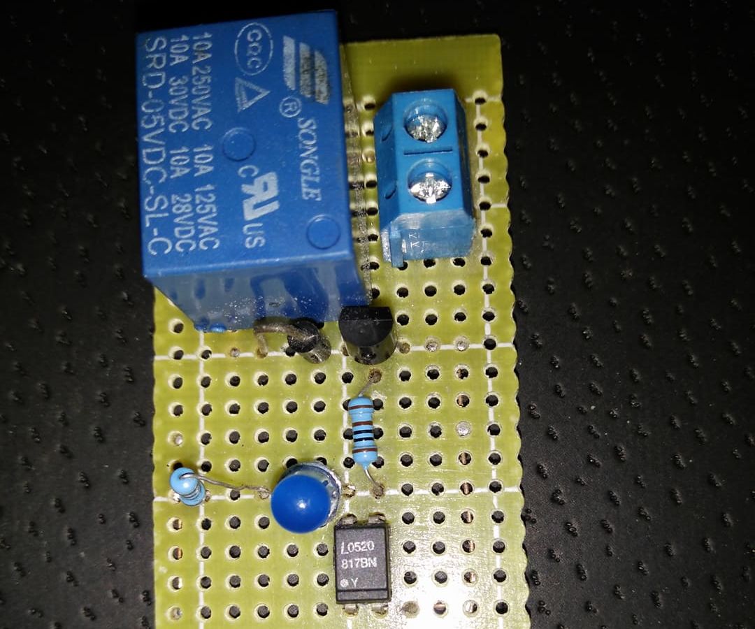

3.a module relay(I mad an inconstructible here ) // or not if your are going to use just and led
4. resistor ( 2.2 k ohm x 1) (3.3 k ohm x 1).
5. LED or bulb lamp .
6. General purpose PCB 10. Breadboard and Jumpers.
* Relay are generally use with the arduino in case of high voltage ,for example an 220v ac to turn on/off a cafe machine *
