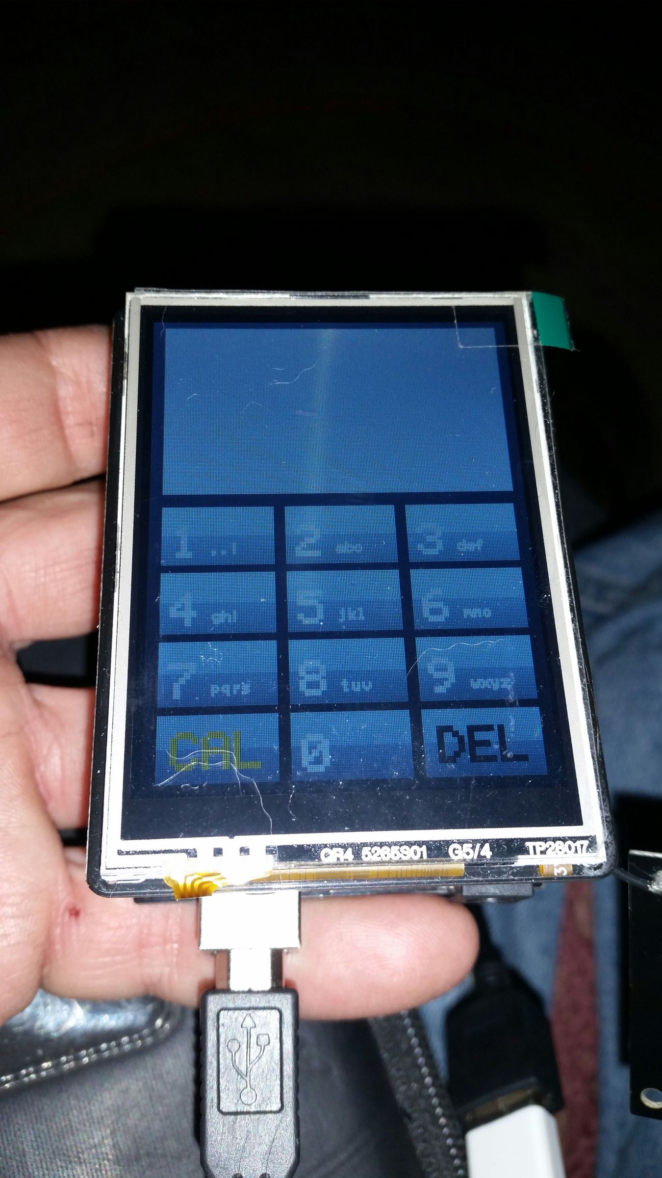

However, a much more difficult problem is that this Arduino Phone hasn’t physical buttons
(except the Reset button switch and GPRS). So, how to manage UI will be a challenging task.
Fortunately, TFT Touch not only provides a display function, also a touch screen function.
Thus, we can manage the UI through gesture, like left-swipe and right-swipe.
It this step, we will show how ArduinoPhone works. And the picture indicates the workflow of ArduinoPhone.
Finally, opening ArduinoPhone.ino with Arduino IDE, then uplaod source code to ArduinoPhone.

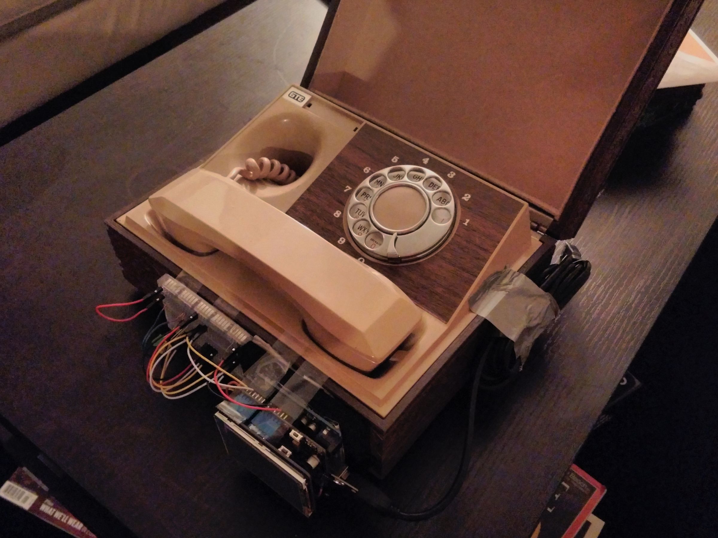

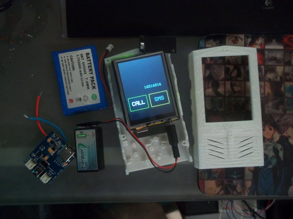

Step 4: Assembling
In order to make it look like a phone, we printed a shell with 3D printer as shown below. Then, assemble them carefully.
This is a troublesome but interesting process. Actually, maybe it will be more interesting if you put them into other shells, such as in shoes( see the picture :) ).
