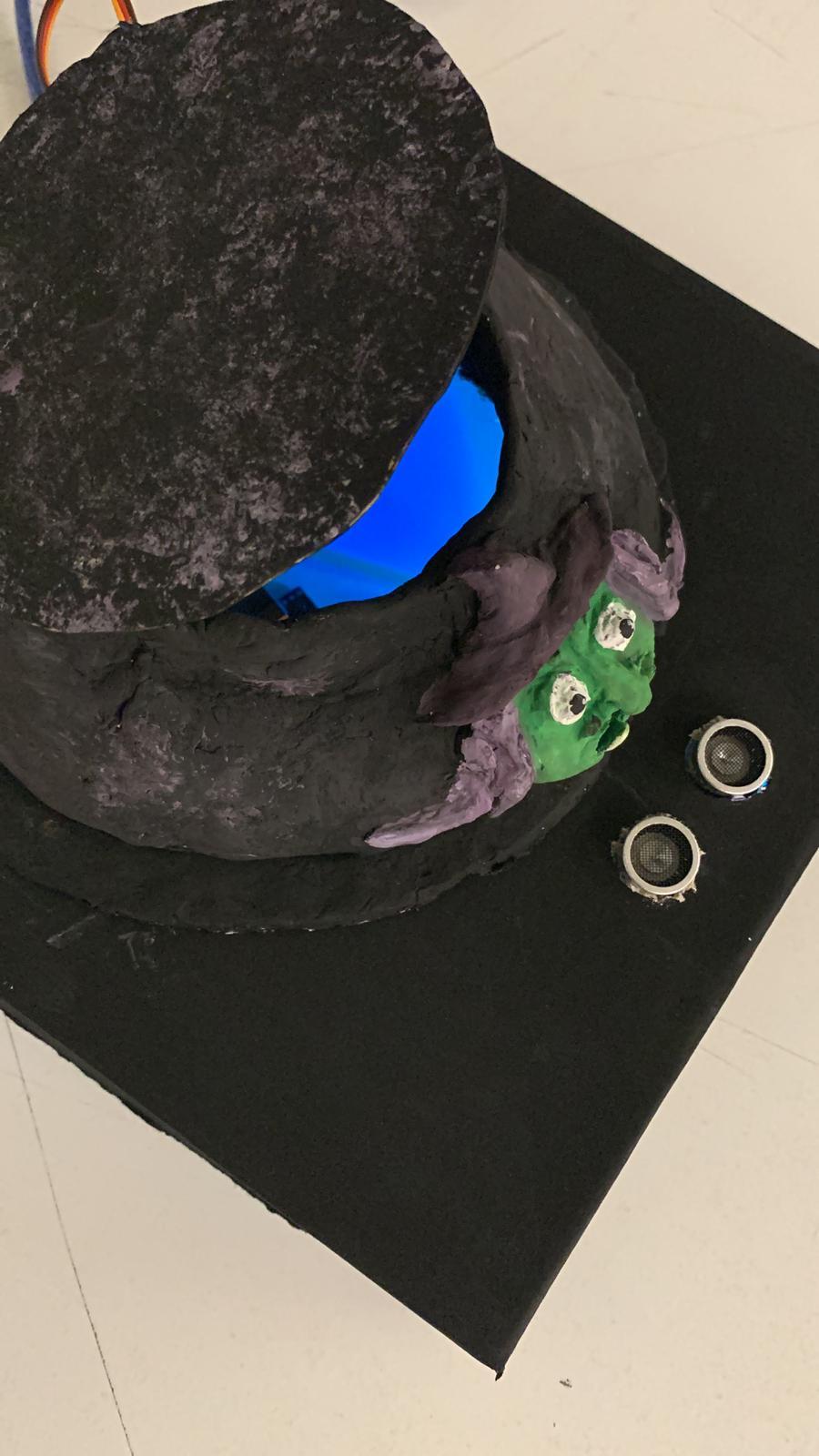

For this project, we have decided to make a witch's cooking pot. This pot will start off closed and will open up when approached. As it opens up, the tune of Harry Potter's theme song will start playing and some lights will turn on and start changing colors from green to purple, and the other way around. After this, when the approacher leaves, the cooking pot will close again.

When we have our components connected correctly, we proceed to build our prototype.
To build the pot, the first thing to do is to measure the dimensions of the arduino and the breadboard and, in reference to this, we draw a circle that will delimit the hole of our pot. From these dimensions we will mold our clay to create the pot, we can decorate it as we wish but it is important to leave a groove in the back where we will fit the lid. For the lid we will measure the top of the pot and it will be made of cardboard to ensure that the motor will be able to lift it. Then we take a cardboard box, if possible recycled, which will be the base of the pot and cut out two circles to put the sensor. At this point we can paint and decorate both the pot and the base and once everything is dry, we proceed to the final assembly.
