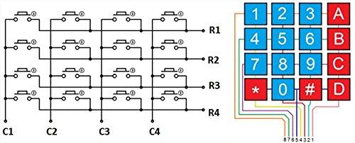

  • Keypad's first 4 pins are row pins then column.
  • Connect keypad matrix pin to Arduino pin (1 = 12, 2 = 11, 3 = 10, 4 = 9, 5 = A0, 6 = A1, 7 = A2, 8 = A3)
