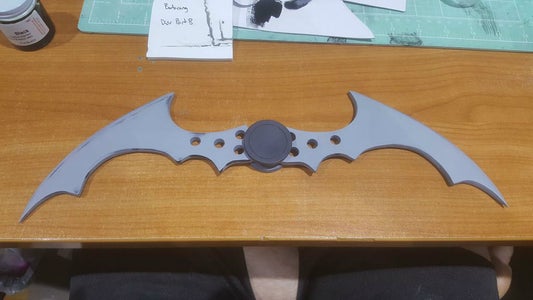

So here is where I originally messed up. The white batarang is the one made from balsa wood, and you can see it was not done as well as it could be, with noticeable wood grain, small half-holes and a kinda broken tip. What I did originally was mold and cast that copy, fixed up that cast and used that as the 'master' for the final molding process. If you do it properly the first time with the wood version you can skip that step and save some money (I wasted so much resin doing it improperly -_-). The grey one above is the 'master' I used for the next step.

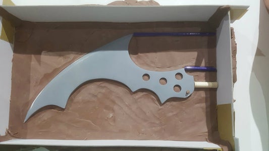

So you can see that it is all smooth and ready to mold above, but it's not yet complete. I cut the plastic part of a Q-tip out and slid it into the small hole to act as a hinge part, and held it in place with some clay. Now its ready.
The materials I used for the next step are shown above, but you should research your countries version of them. The PinkySil Silicone is used for the mold, petroleum jelly is used to keep the 2 halves apart, latex-free gloves are to reduce mess (and latex-free won't mess with the silicone or resin reactions), EasyCast is the casting resin, and the black tint is so the resin cures 'dark grey' (if the final piece gets scratched it just shows grey instead of bright white).

Once everything is ready, you can start making a 2 part mold. First lay out a clay bed for the batarang and shift the clay along the edges of it. I used an exact-o blade to make sure the clay is perpendicular the batarang as it makes the 2 parts easier to join together later. Flatten out the rest of the clay and set up some walls, I had some foam core sheets lying around I cut into shape, but more clay would work fine. Add some registration keys in the clay so the 2 parts can rejoin in place for every new casting, I just took a brush handle and stabbed the clay so there were lots of small 'holes' for the silicone to fill, and added a spout to pour resin in and some escape holes for resin to come out for the tips (to avoid trapped air bubbles). Now you can mix up you silicone (according to the instructions) and pour it in, I did a thin detail coat to make sure there were no bubbles on the actual model. You can use a brush to spread it around thinly, and once that cures you can make a larger batch and dump that in as well, making sure the model is completely covered.
Let that set for as long as needed (mine was fine in 10min, others may need longer), and start taking off the walls and flip the whole thing over. Carefully pull the clay off the mold and clean off any clay that has stuck to it, as you don't want that detail caught by the silicone. Now you need to add a release agent to avoid the silicone from stick to itself, I just smeared petroleum jelly on the surface of it, but using a spray agent would probably be easier/offer more coverage. Make your walls again and do the same as before, a thin detail coat with no bubbles and a thicker skin coat. Once it cures, pull the whole thing apart and take out the batarang, you can chuck that now if you want, now you should have a proper 2-part mold, ready to use! So the casting keeps it shape, you need something to sandwich the silicone together. I cut out some more foam core sheets (can use wood or something else) and used some rubber bands to keep the 2 halves together.

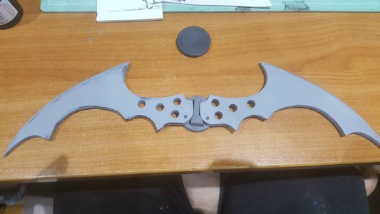

Once it fully cures you can take it out of the mold. It gives off some heat while curing, so you can tell when it's done (seriously, the thicker the resin, the more heat it gives off, you can feel it through the silicone jacket). You should have a replica of the original you made from wood, with some excess resin along the seams and pour in spout. I took an exact-o and cut off most of that, and then used some 180-240-400 grit sandpaper to clean everything up, and cast another copy to have the 2 parts of the batarang. Now we need a middle part, where the blades can hinge on and close up.
Now you can take some wood, trace out a circle and do the same as before (cut, sand, refine, mold), but I couldn't cut out a perfect circle so I was able to do something easier (may not be possible for you though). The lid of my resin tint was the perfect size to act as the middle of the batarang, so I pressed into some clay and just poured in a tiny bit of resin to make a small disc. Let that cure, sanded that down a little and I carved in a smaller circle with a compass and exact-o blade for mine, you could carve in a bat or nothing if you want, and I drilled in some small holes in the inside of it for the blade hinge pole to catch on (the blade is sandwiched between 2 discs and it swings along them). I made a mold of it using the same method as before, took a second copy of it and used some scrap wood/clay to make a wall along the middle of the disc. The blades will stop against this when open and shut, and the thickness will lock the blades together (I explained it badly, you get the point in the photos). I made another mold of that piece, and the is every piece of the batarang molded and casted in resin.

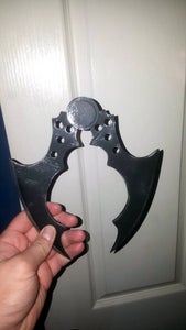

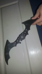

Now this is the last step before you have your own Arkham Style Batarang. I wanted it to stay open on its own and close, so I added some small magnets in the end of each blade (I think 3mm wide, the blade was 6mm thick at this point from filler build up). I drilled a small bit into each blade and superglued in the magnets, and the wall part of the discs stop them from smashing together and breaking/ripping out. I did some test fits before painting to make sure everything worked fine, and started painting.
I sprayed everything with 2 coast of flat black paint, had to hang the blades on some cord to get decent coverage. Once that dried I did something called dry brushing with silver acrylic. Essentially dip a brush into a small amount of paint, wipe most of it off the brush with a paper towel and lightly brush the blade so it looks like it's scratched/damaged. I did the whole blade like that, do it in small amounts so you don't add too much. To do the edges, I masked off the inside blade and just heavily dry brushed it so it was mostly silver with flecks of black.
Cover every piece with some clear coat to protect the paint (I used matt spray, can use gloss or satin), fit everything together and superglue the 2 discs together, and you're done! You now have your very own 'working' batarang replica, it just won't be stopping any criminals any time soon. I got it next to my Dawn of Justice batarang for scale, so with each blade being 19cm, it's a whopping 40cm wide (may have been better to scale it to 15cm per blade). You can scale it down in the initial stages if you want, Batman is just a huge beast in the games.
