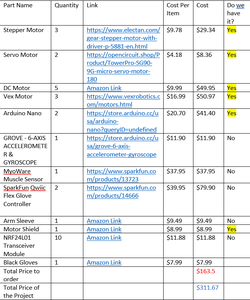

The goal of the project is to create a mechanical arm out of 3D printed parts that can mimic the movement of a user’s arm using sensors attached to them. The build will use different sensors to detect muscle movement from the person and control the arm as close to their movement. This can be a steppingstone in creating arms for people who have lost an arm and do have not enough remaining muscle for normal prosthetics. The design can also be used to interact with objects at a further distance where the environment is not suitable for human presence
- x2 Stepper Motors
- x2 Vex Servo Motors
- x2 Vex Motors
- x4 TT Motors
- Arduino Uno
- Arduino Mega 2560
- Myoware Muscle Sensor
- x2 Transceiver Modules
- x2 Stepper Motor Driver
- x1 H-bridge
- Hookup Wire
- Solder
- Shrink Tubing
- 1/4" wood
- 3D printing filament (PLA and PETG)
- 12V power supply
- Nuts and Bolts
- x5 Potentiometers
- Buck Converter
**Note that the bill of materials was centered on what we had in the engineering room, so some of the things on the list are not included because we already had them.**

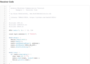

The electrical system will involve a lot of different sensors to detect movement on the user’s arm. Since the sensor system would need to be wireless from the mechanical arm, I would need to use a transceiver module to make the Arduinos communicate with each other. To use the transceiver module, I would need to learn about how to program the module to work with the Arduinos. To take up as little space as possible, I'm going to use 2 Arduino Nanos to use. For the movement of the arms and hand, I will use a combination of step motors, dc motors, servo motors, and possibly Vex motors. Depending on the location on the arm, the motors used will need to be able to lift the weight of the mechanism. To make the design as light as possible, I will place holes inside the arm design to reduce material usage and thread wires through the arm. To plan out all the electronic parts, I would use Tinker cad.

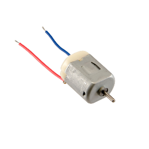

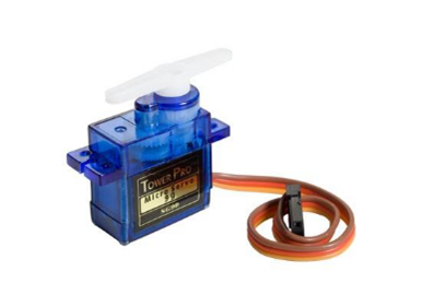

Before designing and building the mechanical arm, I had to assess all the materials I have planned on using. Since a lot of the motors were unfamiliar to me, I had to test all the motors by writing up sample code and analyzing the strength and accuracy of each motor. Coming into the project, I was going to the small stepper, servo, and DC motors

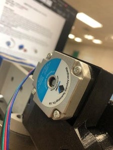

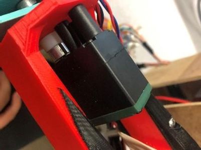

After testing the motors, however, I realized that these sets of motors were too weak to hold a robotic arm. I had to look around and see what else was available and came across a broken 3D printer that I could scrap. From the 3D printer, I made use of its stepper motor and power supply to incorporate into the arm. I also made use of Vex servo/DC motors and geared up DC motors as well.

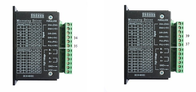

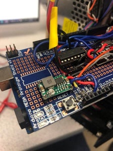

Aside from figuring out motors, I also needed to assess the electronics I would use in my arm. I wanted to control the arm wirelessly, so I made use of transceivers that would do that. Since the goal is to make it muscle-controlled, I needed to make use of the MyoWare Muscle Sensor in my project. I investigated purchasing stepper motor controllers to connect to my power supply and incorporated a motor shield to drive 4 DC motors. To run the remaining 2 motors, I used an H-Bridge. I also needed to make use of both an Arduino Mega 2560 and an Arduino Uno. Since the arm will use a lot of electrical components, the Mega was allocated to the arm and the Uno to the controls system.

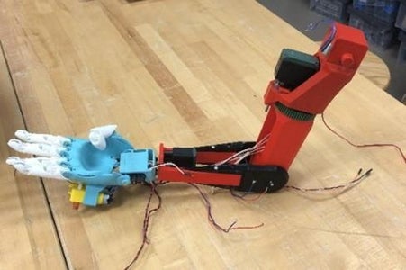

To design the arm, I began by outlining the axis of rotations that the robot was going to move in by using a diagram to visualize the movement. I then made a list of the part of the arm and motors that are associated with the motion.

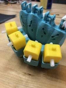

After getting a general idea down, I began using Fusion 360 to model the arm and placed them in an assembly. I was able to use a prosthetic hand from E-nable as a basic design for my hand. I modified the hand to fit motors through Fusion and modeled the rest of the arm separately. After assuring that all the parts fit together, I began 3D printing each piece of the arm and assembling it from the hand to the shoulder.

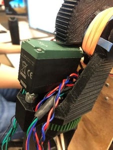

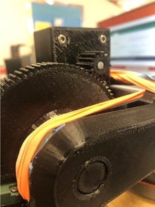

Despite being planned out, there was a major flaw that was overlooked that caused me to redesign the arm. I did not consider the great amount of force needed to move the elbow and the shoulder, which meant that it needed to be geared so that it would move. I had previously thought that rubber bands would have been enough to help the stepper motors move. With a lot of weight at the end of the hand, however, the arm needed more torque to move. I had to re-CAD certain parts of the arm to include a torque gear ratio and used the Gear Add-on in Fusion 360 to help me redesign and rebuild the arm.

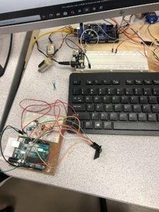

Although a lot of the electrical design began after building the arm, I began to experiment with the electrical aspect of the project before design. I first hooked up the muscle sensor to a basic Arduino Uno to get a better understanding of how it worked. Once I was done, I moved on to experimenting with power supplies, DC motors, servo motors, transceivers, and stepper motors.
This process was part of the material gathering process by testing each component. After determining my electrical components, I focused my attention on designing the arm before I began to mess with electrical components. After most of the arm was constructed, I started implementing all the information I gathered from the experiment into the main circuit. I first soldered the transceiver onto the prototype board and connected all the wires that connected to the two-stepper motor controller and. I then stacked a motor shield on top of the prototype shield to connect the two-servo motor and 4 DC motor. After testing the components, I moved towards connecting the h-bridge to manipulate the two vex motors and adding a buck converted to step down the voltage coming out of the power supply.

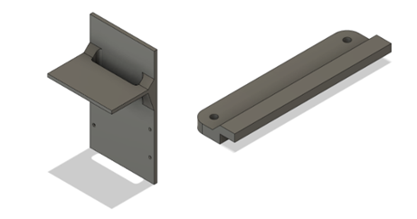

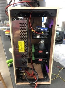

After connecting all the electrical components, I knew that I would have to make the housing for them accessible in case I had to adjust. In Fusion 360, I made a CAD of a shelf-looking design that would slide in and out of the box. This allowed me to modify certain circuits a lot faster and made the redesign process of the electrical aspect of the project more efficient.
Apart from the robotic arm, I had to also design an efficient controls system to test and control the arm. I first made use of potentiometers to control each DC motor on the fingers while testing. After finalizing the circuitry on the arm, I then added buttons and a switch to control all the DC motors (Vex included) and used the potentiometers for the wrist, elbow, and shoulder.

I first began by experimenting with the motor shield and stepper motors to determine how the code works for each motor I was using. I had already had experience with coding servos, but since I was using a motor shield, I had to determine how to utilize the libraries included with these components and get an understanding of how they work together. I began using the example code from makersguide.com, aranacorp.com, and instructables.com to make a simple sequence for the motors.

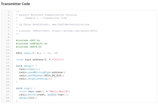

After figuring out how the motors worked, I moved on towards programming the transceiver. Unlike programming the motors, I had no background experience in programming anything like it, so it took a lot longer to figure out how it worked and how to program it. In the end, however, I was able to understand how to program it with the help of howtomechatronics.com and the Arduino Forums. Essentially, the transmitter packages all the values into an array and sends them to the receiver, where it computes and uses all the values to control the components on the other circuit.

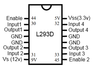

I also made use of the h-bridge to control the vex motors. I had some experience with the IC, but overall coding it was a hassle. Using the tutorial provided by lastminuteengineers.com, I coded the h-bridge into a function to make the code more manageable. Unlike the servos, motor shield, and stepper motors, there was no library to code the h-bridge, so I made my own function to simplify the process.

After finishing the design and confirming that the arm could move with the test code, I moved on to testing the electronics. I hooked up all the motors on the arm and used the controls system with the potentiometers to control the elbow and shoulder first. After that, I moved on to testing the servo motors with the other two potentiometers. In doing so, my Arduino blew out, meaning that there was a flaw in my circuit. I did some research and found that there was too much voltage going into the Vin pin of the Arduino, so it was drawing current too fast. I purchased a buck converter to fix the issue and a new Arduino. After that was all finished, I moved on towards messing with the 2 vex motors. For a while, the h-bridge controlling both motors was not responding. As a result, I had to rewire the h-bridge and redownload code to figure out the issue. After a few attempts, the h-bridge seemed to work smoothly with the Vex motors. I moved on towards testing the arm by making a rock-paper-scissors mode and a control mode. I made the arm play rock-paper-scissors to test how the motors behaved with each other and later tested the controls system to determine the accuracy of the controls system.
