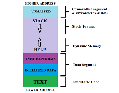

Step 2: C Memory Model
Heap Memory – This is used for dynamic memory allocation. When we create a new instance of an object using ‘new’, or if you allocate a block of memory using malloc and friends, you use memory in the heap.
Static/Global memory – Global and static memory are values that are allocated for the entire lifetime of the program.If for some reason you have data that is fixed (such as a lookup table), you’d be much better making sure the compiler can allocate it in FLASH to save valuable RAM space. We could use the C keyword “const” to tell the compiler the variable will never be changed.
Stack – The Stack is used to store types of variables that have a fixed lifetime based on how C programs run. It is a section of RAM that grows and shrinks as the program runs. When you call a function, its parameters and any variables you have defined in that function (which are not static) are stored on the stack.
