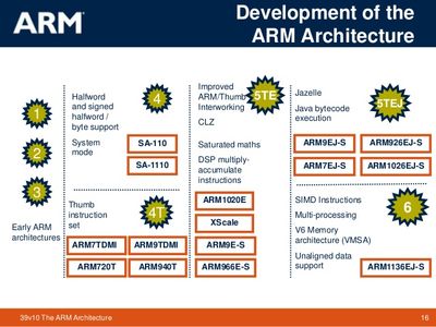

Step 1: Development of ARM Architecture
ARM is a 32-bit reduced instruction set computer (RISC) instruction set architecture (ISA) developed by ARM Holdings. The ARM architecture is the most widely used 32-bit ISA in terms of numbers produced. The simplicity of ARM processors makes them suitable for low power applications. As a result, they have become dominant in the mobile and embedded electronics market, as relatively low-cost, small microprocessors and microcontrollers. This has meant an increasing dominance in the mobile and battery dependent electronics market, where the double advantages of respectable computing power coupled with low electrical power consumption are both desirable.
