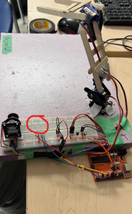

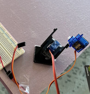

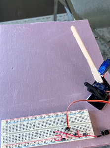

Step 1: Construction & Assembly

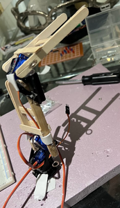

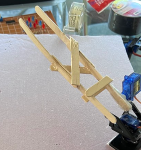

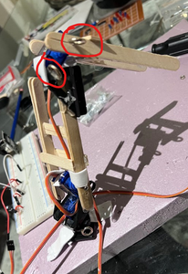

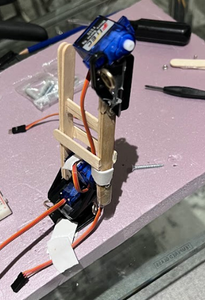

To begin constructing the robotic arm, start by preparing the base using the "Foamular" Foam Core Board as a stable platform. Securely attach the base servo onto the Foam Core Board using 1/8" nails, ensuring it is positioned securely for stability. Next, assemble the main chassis of the arm using approximately 14-18 popsicle sticks. Use a hot glue gun to firmly glue the popsicle sticks together, forming a robust frame that will support the arm's structure. Make 2 popsicle stick glued back to back on each other, and make 4 of these in total. Bridge and connect pairs of these with snapped popsicle sticks in between to produce a sturdy "H" shape, where the middle stabilizer is placed lower (as this will be important later). Use a screwdriver to prep connection holes on the lower end of both of these. You should have 2 H shapes.

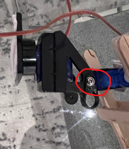

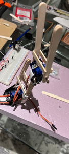

Mount the servo motors onto the popsicle stick chassis using double-sided foam mounting tape. This tape provides a strong adhesive bond and helps dampen vibrations. Ensure each servo is firmly attached to the chassis to withstand movement during operation. Additionally, reinforce the servos with hot glue around the edges where they meet the popsicle sticks for added durability, and use a servo bracket to be helped in place and stable. For the base servo motor however, figure out where you would like to place it on the board, and use nails to nail in the platform bracket in place into the foam core, in order to have a sturdy, and less prone to bend, setup for the first and key servo. The 2nd servo should attach right onto the base, accommodating for the H structures as the arm, likewise the third servo and 2nd arm will be fixated at the top of the first H using hot glue, a bracket, and mounting tape.
Install 3/8" screw hooks at the joints where segments of the arm will connect. These screw hooks serve as hinge points, allowing the arm segments to move smoothly. Use 3/8" screws to securely fasten the screw hooks together at the joints, ensuring they are tightened enough to prevent any looseness or wobbling. Ensure that these screws do not go too far into the joint of the motor, otherwise it will impact the gear turning ability within the Servo, and potentially damage the motor.
Once all segments are connected and the servos are mounted, conduct initial testing in terms of mechanics. Verify the range of motion and functionality of each servo motor individually to ensure they operate smoothly without any binding or interference, and ensure that the max range positioning for each motor is sensible for an arms degree of freedoms. This arm has 3 degrees of freedom, and no claw as it is proof of concept, however you may add more if you will. Make necessary adjustments to servo angles and arm movements as needed to achieve desired functionality, and use the attached images as guidance and reference.
Note, if you are having issues with the balance and stability of the arm within its max reach with all 3 degrees of freedom extended fully, use rubber bands to serve as a tension-based counter force against a forward lean, and fixate it towards the opposite end of your motors initial placement to generate tension.

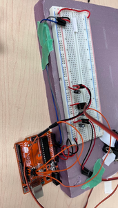

Step 2: Wiring

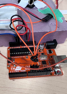

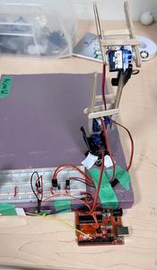

Close to the fixation of the base of the arm, or in place where there will be no interference, apply your breadboard by using the adhesive sticker on the back, and prepare for wiring. Note that a lot of wires will be exposed as the Servos need movable and unrigid wires to enable their access to their respective degree of freedoms.
Servo Motors

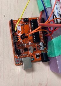

To connect the servo motors, start with the Base Servo by attaching its signal wire to digital pin 9 on the Arduino Uno. This pin will transmit control signals to the servo, allowing precise positioning of the arm's base. The servo's ground (GND) wire connects to any of the Arduino's GND pins, completing the circuit and providing a return path for current. The power wire of the base servo connects to the 5V pin on the Arduino, ensuring the servo receives sufficient power to operate smoothly without voltage drops.
Next, for the Arm1 Servo, connect its signal wire to digital pin 10 on the Arduino. This pin serves as the control interface for the arm's first joint, enabling movements along its horizontal axis. Similar to the base servo, connect the servo's ground wire to a GND pin on the Arduino to maintain a common ground reference. The power wire of the arm1 servo also connects to the Arduino's 5V pin to ensure consistent power supply during operation.
For the Arm2 Servo, connect its signal wire to digital pin 11 on the Arduino. This pin controls the movements of the arm's second joint, facilitating adjustments along its vertical axis. As with the other servos, connect the ground wire of the arm2 servo to a GND pin on the Arduino to complete the electrical circuit. The power wire of the arm2 servo connects to the Arduino's 5V pin to provide stable voltage for optimal servo performance.
Digital pins 9-11 on the Arduino Uno are capable of PWM (Pulse Width Modulation) ensuring that different signals of voltage can be outputted and controlled to produce a moving mechanical motion with the motor's gearboxes. Double check the wiring as this is important.

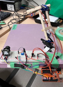

Moving on to the Sunfounder Joystick, connect its X-axis (horizontal) pin to analog pin A0 and its Y-axis (vertical) pin to analog pin A1 on the Arduino. These connections enable the Arduino to read the joystick's analog signals, translating physical joystick movements into digital values for controlling the arm's position. The VCC (power) pin of the joystick connects to the Arduino's 5V pin to supply operating voltage, while the GND pin connects to a GND pin on the Arduino to complete the circuit.
For the Potentiometer, connect one end to the 5V pin on the Arduino to establish the maximum voltage reference. The other end of the potentiometer connects to a GND pin on the Arduino, setting the minimum voltage reference. The middle pin (wiper) of the potentiometer connects to analog pin A2 on the Arduino, allowing the Arduino to read the voltage level set by adjusting the potentiometer's knob. This setup enables precise control over specific functions of the robotic arm, such as speed or sensitivity adjustments.
Control - touching base on the way the operation and control of this arm is supposed to work - the X axis of the joystick controls thee 0 to 180 degree range of the BASE servo motor, whilst the Y axis controls arm 1, which is lower and fixated to the base motor. The potentiometer controls the range of motion for arm2, and is separate from the joystick. In this build I did not utilize the z-axis of the joystick which was its switch/pushbutton - however feel free to integrate a claw mechanism that opens and closes by the push of the z-axis button. Also throughout this build, it is highly recommended that you use some of the mounting tape from earlier, or some electrical tape, to make neater wiring along the sides of the foam core to ensure there's no "spaghetti" jumble of wires. Tracking the wiring yourself will be important for later as you need to clearly identify your connections for the programming component.
RGB LED
Finally, for the Common Anode RGB LED, begin by connecting its common anode (longest pin) to the 5V pin on the Arduino. This connection ensures that the LED receives sufficient voltage to emit light across its color channels. Each cathode (red, green, blue) of the RGB LED connects to separate digital pins on the Arduino (red to pin 4, green to pin 3, blue to pin 8) through current-limiting resistors (e.g., 330 ohms). These resistors prevent excess current flow through the LED, protecting it from damage and ensuring consistent brightness levels across different colors.
For fun, I additionally added a simple, non programmable green Led connected through a 330 ohm resistor (to keep from fusing) and connected to the 5V power rails and GND common rail. This added a simple yet nice analog touch to the system.
Arduino Connections Summary
  • Vcc (5V) - power rail
  • GND - common rail
  • A0 - x-axis of Joystick
  • A1 - y-axis of Joystick
  • A2 - potentiometer for Arm 2
  • pin 2 - green pin of RGB
  • pin 4 - red pin of RGB
  • pin 7 - joystick switch/pushbutton
  • pin 8 - blue pin of RGB
  • pin 9 - base servo signal
  • pin 10 - arm1 servo signal
  • pin 11- arm2 servo signal
Final Checks
Verify each connection to ensure they are securely attached and properly insulated to prevent short circuits or loose connections as with this meticulous wiring setup, there s much room for error that we want to eliminate, and ensure that only programming is now part of our worries. The wiring ensures that all components of your robotic arm system are correctly interfaced with the Arduino Uno, and I used electrical tape for making bunches or clusters of wires more neat together, alng with double sided foam mounting tape by the servo motors to ensure a clean straight path downward for the signal, ground, and power wires, whilst maintaining tightness.
Step 3: Programming Control & Operation
Variables and Setup
We begin the code by including the Servo library, which provides convenient functions for controlling servo motors connected to Arduino. Three servo objects are declared: base, arm1, and arm2. These objects will be used to control the position of the respective servos connected to the Arduino. Each servo is associated with its signal pin: base_pin, arm1_pin, and arm2_pin. These variables define where each servo's control signal is connected on the Arduino board, typically to digital output pins.
Analog input pins are allocated for interfacing with external analog sensors. Specifically, base_joy and arm1_joy are designated for reading joystick inputs, which are often used to provide manual control over servo movements in two dimensions (x and y axes). The arm2_pot pin is assigned to read from a potentiometer, which provides a variable resistance that translates to a specific angle for servo arm2. These analog inputs allow for intuitive and proportional control over the robotic arm system.
For visual feedback and indication, pins green_pin, red_pin, and blue_pin are configured as outputs - and these pins are intended to drive a common anode RGB LED, where each color (green, red, blue) can be individually controlled to visually represent different states or actions of the robotic arm. This setup enables the user to easily interpret the system's status or mode through color-coded signals.
Initial positions of the servos (init_x, init_y, init_z_pot) are set to 90 degrees. This establishes the starting orientation of the servos when the Arduino board is powered on or reset. These initial angles serve as a reference point from which the servos can move in response to input from the joystick and potentiometer.

Anyhow, throughout this instructable, we've combined robotics with practical programming skills to create Armduino, a three-degree-of-freedom robotic arm - and by integrating servo control, joystick and potentiometer inputs, and RGB LED feedback, we've explored the essentials of automation and electronics. This project serves as a practical introduction to robotics, emphasizing wiring, sensor integration, and Arduino programming for enthusiasts looking to delve into automation projects.
Thank you for reading and I encourage for you to add a personal touch or addition to this project if you attempt to replicate it.
